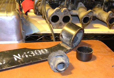

This afternoon I removed the rubber bushings from some of my suspension components.
I used cheep tools from Harbor Freight. I have had a 6 ton shop press for years, So earlier in the week I popped over to Harbor Freight and picked up a bushing/bearing driver kit and a few things that were on sale (a cotterpin assortment, a metric grease fitting assortment, a couple of flourescent lights, and some other odds and ends).
I looked at what I had, and realized none of the drivers in the bearing driver kit were large enough to handle the bushings in the Mustache bar, I checked a few of my sockets, but I had loaned out my large ones. Then I thought all you need to do is punch a hole in this bushing. i had picked up a $2.50 9pc hole saw kit, and sure enough, the 1&3/4 40mm blade was a good fit. I placed it teeth down on the bushing and placed a 2" pipe nipple under the bushing and pressed most of the rubber out with ease, withing 5 minutes, both sides were finished. I took the bar outside, and poured a little MEK on the remaining rubber, and left it to work.

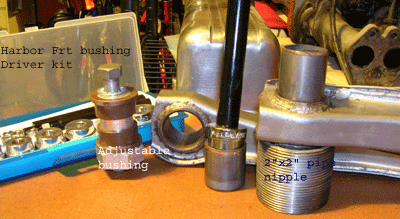

Next, I removed the bushings from the front suspension arms in two parts
First I pressed out the inner sleeve that the bolt goes through. I just used a 2" pipe nipple at the base of a 6 ton Shop Press and used the ram of the press to push out both center sleeves.

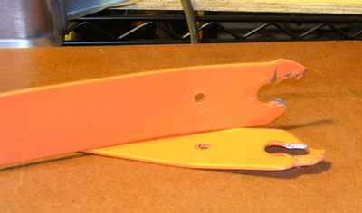

Then I used the 1&3/16" x 1&5/16" bearing bushing driver insert (it actually is stepped and the smaller step fits into the outer sleeve while the larger step come just to the outside of the larger sleeve) between the ram and the bushing collar-it pressed the first one right out. The second one was not moving. As I added more pressure, I started to hear things snapping, so I stopped, backet off the pressure, and found the frame of the press had succumbed to the pressure-I have had this press 10 years, and abused it well beyond what i expected for the $60 I paid for it, so I was going to go down to Harbor Freight and get a better one-I found a 12 Ton on sale for $80-but a phone call to the local store revealed that they did not stock that one. So I had one side that was complete and one side that was related to a typical spindle pin. I tried the three pieces in the vice and squeezing, but no dice. This was not going to beat me!
Then I put som PBBlaster on the sleeve, placed the 2" pipe nipple on a 1/4" steel plate, put the bottom of the bushing inside it, and took the bearing driver insert, mounted it on its drift, and wailed on ity with a 3# hammer. Ten minutes later, the sleeve was out.
Other than the $60 press, I used a blade out of a$4.99($2.50 on sale) hole saw kit, a driver out of a $9.99($5.99 on sale)Bushing/Bearing kit, a pipe fitting, and $6.99($3.99 on sale) hammer.

As I added more pressure, I started to hear things snapping, so I stopped, backet off the pressure, and found the frame of the press had succumbed to the pressure...
Will, I've been there before, especially with tools from Harbor Freight. Well, not really the tools, but more the equipment. I'm on my 2nd 6" vice and will be returning it for my 3rd! I don't have a press, so I use the vice for pushing out bushings. I broke the 2nd vice here about 2 weeks ago! :eek: Luckily, Harbor Freight has taken them back no questions asked. When they stop, I'll break down and get a good vice. Can't expect too much when I only paid $32 for it.
