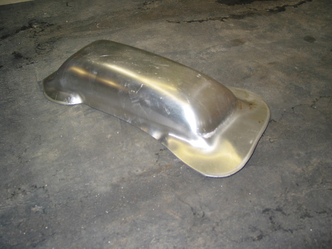

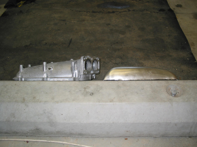

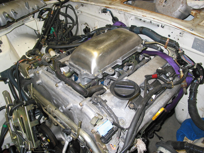

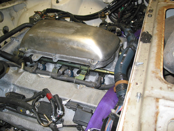

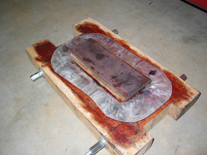

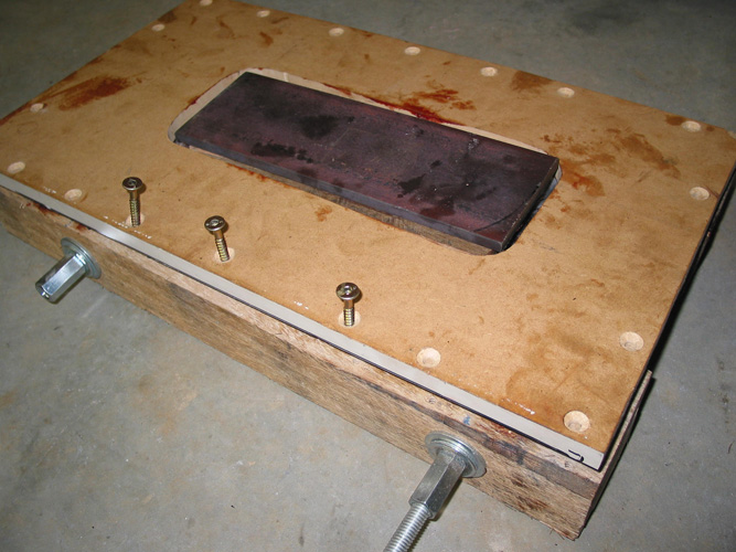

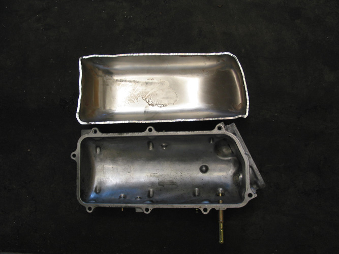

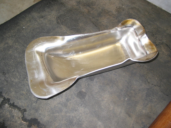

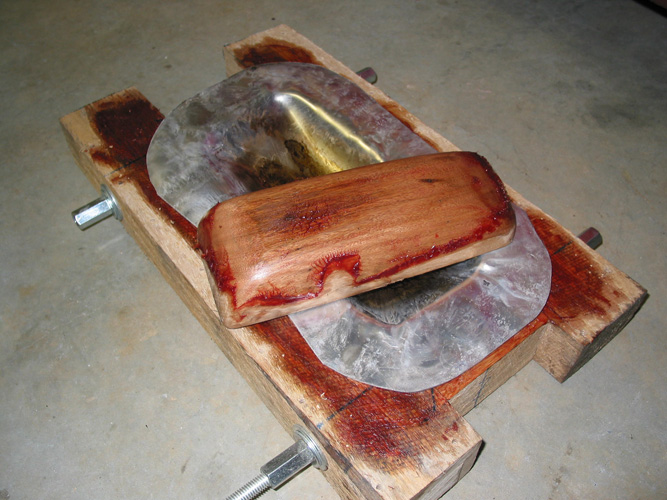

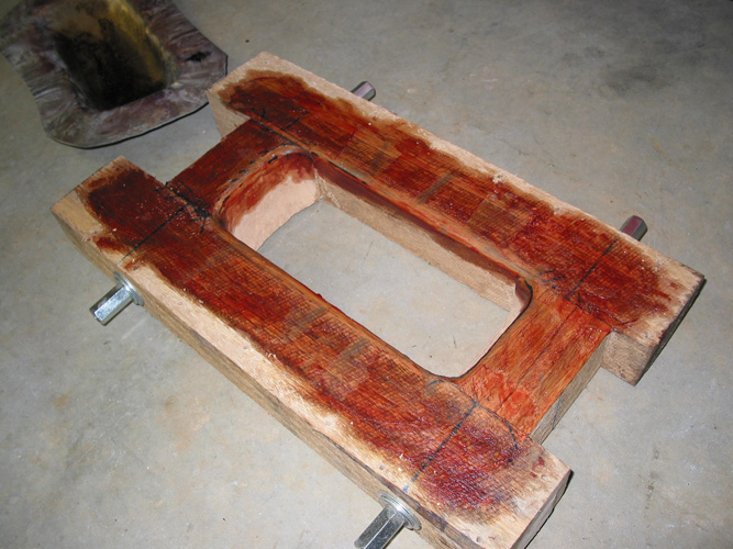

I have some photos of the plenum that I pressed this weekend. It is made from 3mm thick 5005 alunimium that was annealed first, and then part way through. We used a 20tn press and the frame for thisjig is made from hardwood, and so is the male part.
Robert
