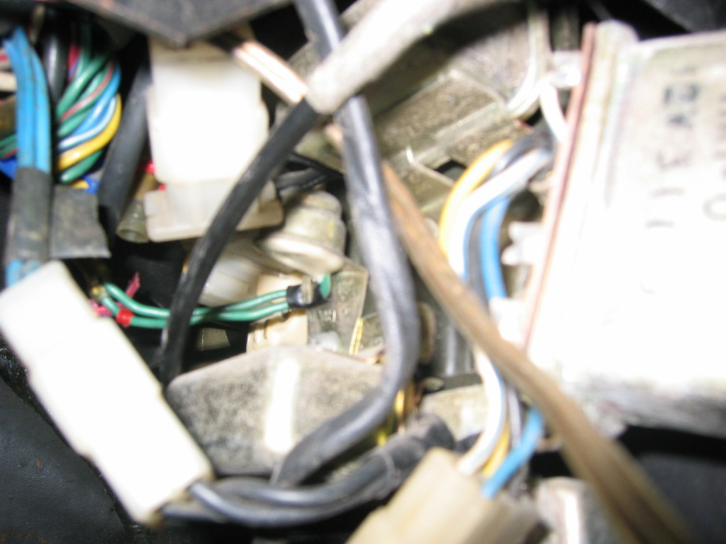

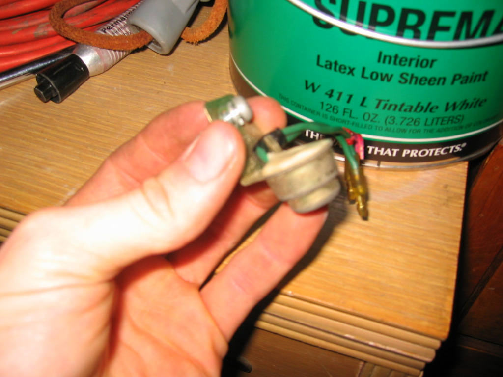

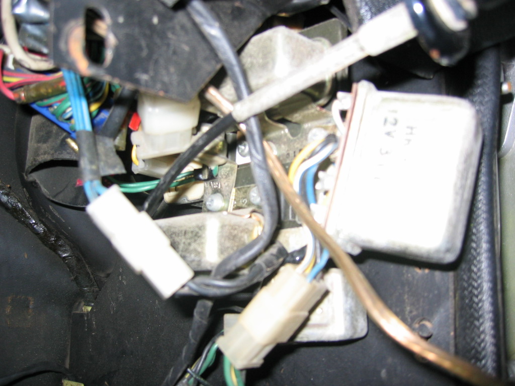

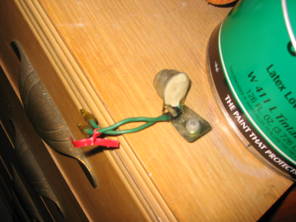

Or rather I think I've found it. If you take a quick moment to visit my gallery you'll see the pictures I just uploaded. I can't link them for you now because they are pending approval or something. But that's my kick panel and that's the piece I pulled out. it's the only round component I could find that even remotely resembles a barrel; everything else is rectangular as can be seen. It has two green wires coming off of it. I can take it out, but I don't know how to test it. It seems simple so I checked for continuity. I mean if it's a flasher it should have a bimetallic strip or something that creates contact or closes the circuit but then heats up and bends away opening the circuit much like a circuit breaker in a house, but I'm not really sure.
I then tried to bypass and close the circuit with a jumper in place of that component, but my hazards didn't come on. I half expected them to come on with a pull of the switch as power was directed through my jumper but stay on as there was no flashing unit; keep in mind I'm still guessing, as I don't know if it's even the right part yet. But it was to no avail I didn't see any hazard/brake lights come on. I'm ready and willing I just need more direction.

I've got a 71 and a 72, but I don't think that's the Hazard Flasher. I may be wrong, but it looks more like the KD Solenoid for the KD switch on an Automatic car.
But now that I think back, you might check directly behind the radio on the driver's side. There should be two flasher's there. The Turn Signal one is right by the Steering Column and the Hazard one is closer to the center console. But they both look like standard flashers.
Check that out, I'm still betting on it being your flasher that's out.

It turns out that the little electrical "drum" I am holding in the picture was not my hazard flasher/relay, but the boxy guy to the the right of him in the kick panel was. I tried to replace flasher/relay with my buddy's good one, but the brakes and hazards still didn't work.
