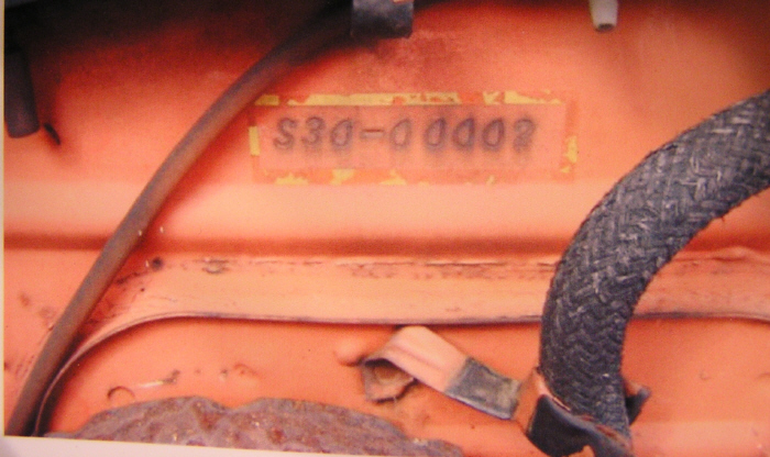

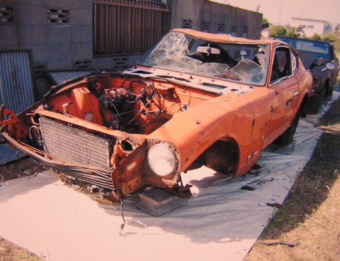

kats Posted July 20, 2005 Author Share #25 Posted July 20, 2005 Hi, just information,Mr.Harigae found and bought S30-00002.The car is almost unable to restore but very interesting to look at it. If I have a chance to see it,I would like to see a wiring harness and check date on the decal,I guess S30-00002 was born in June or July 1969. kats Link to comment https://www.classiczcars.com/topic/15170-keep-working/?page=3#findComment-131249 Share on other sites More sharing options...

Mr Camouflage Posted July 20, 2005 Share #27 Posted July 20, 2005 Hi, just information,Mr.Harigae found and bought S30-00002.The car is almost unable to restore but very interesting to look at it.If I have a chance to see it,I would like to see a wiring harness and check date on the decal,I guess S30-00002 was born in June or July 1969.katsHi Kats, thats an amazing findI started a new thread about it, hope you dont mind. http://www.classiczcars.com/forums/showthread.php?p=137561#post137561 Link to comment https://www.classiczcars.com/topic/15170-keep-working/?page=3#findComment-131261 Share on other sites More sharing options...

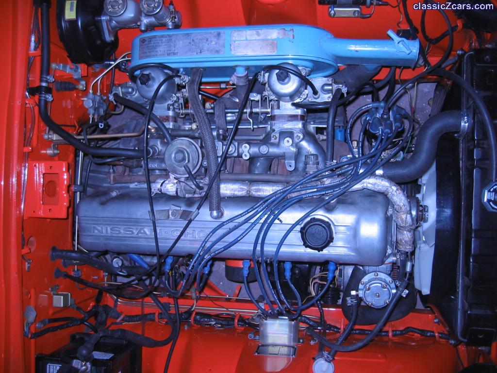

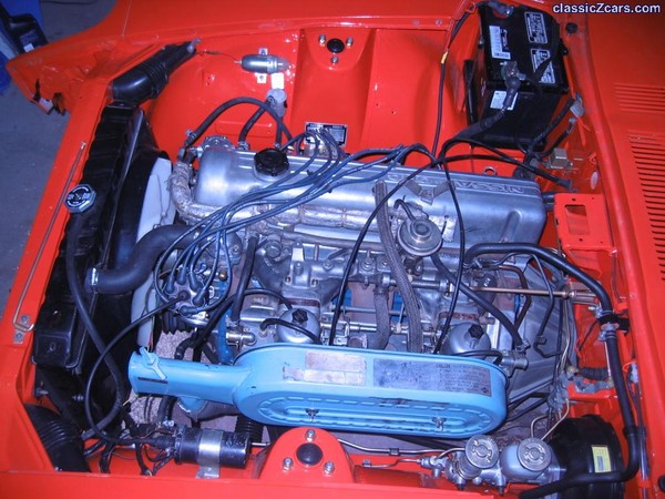

kenz240z Posted July 20, 2005 Share #28 Posted July 20, 2005 Hello everybody, My '73 240Z has a blue air cleaner. It has the flapper in the "snoot" that can be toggled for winter/summer driving. The snoot has a large, round port on the bottom that connects to the heatshield on the exhaust manifold to supply warmed air for winter driving. The backing plate has a port that angles downward, but is currently capped off with a section of hose with a plug in the end. I'm guessing this would have tied into the smog pump somehow. None of the air hoses were hooked up to the smog pump when I bought the car, so I've since removed it. I would have to say it is not original to my car, as somewhere in it's life before I purchased it the square top carbs were replaced with round tops. I've attached a couple of pictures of the blue air cleaner from my gallery. I can take a close up of the decals, but it will be a few days. My Z is currently at the shop having the valves in the rebuilt engine adjusted, and a new header & exhaust system installed. Link to comment https://www.classiczcars.com/topic/15170-keep-working/?page=3#findComment-131300 Share on other sites More sharing options...

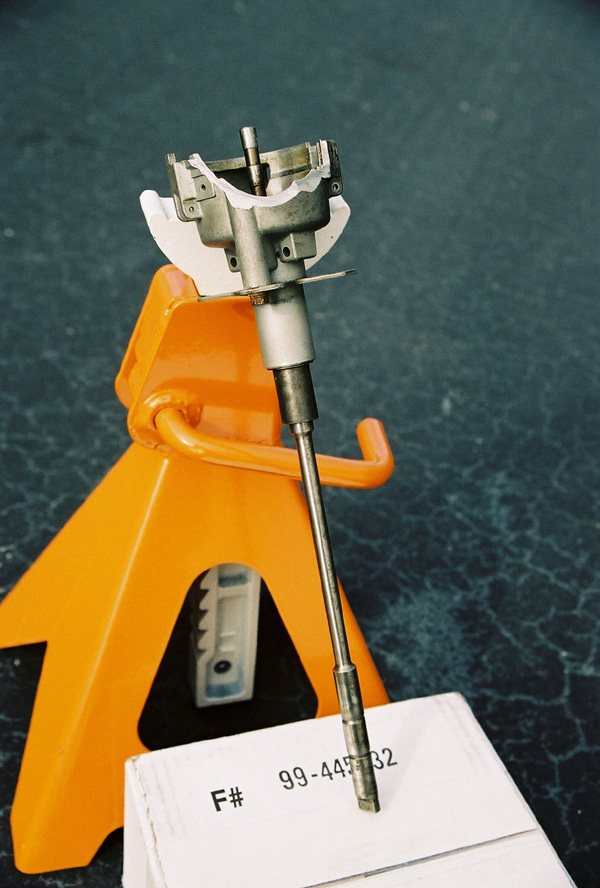

26th-Z Posted July 20, 2005 Share #29 Posted July 20, 2005 I think you are correct, jmark. However, there appears to be several different kinds of series I air cleaners. Upon further research, I have my original, a later series I version with an additional fuel line breather hose, and what appears to be an air cleaner for an S20 engine - early. But speaking of distributors.... Here is a picture of my special distributor. A tool made for pumping oil through an engine on the stand. The body has been carved away so that a drill motor can be attached to the shaft and drive the oil pump. Not exactly stock. Link to comment https://www.classiczcars.com/topic/15170-keep-working/?page=3#findComment-131301 Share on other sites More sharing options...
kats Posted July 21, 2005 Author Share #30 Posted July 21, 2005 Hi kenz240z, Blue air cleaner I saw it some times in Japan too.I think blue one is nothing different just color.Remember I post before the car which is seen in the earliest service manual have a blue air cleaner.This is interesting.26th-Z,I found your distributer's shaft maybe the rarest according to parts catalog."xxxxx-21005" is superceeded -21006 in Nov 1969.I think this change could be a first time among of HLS30 hole parts.kats Link to comment https://www.classiczcars.com/topic/15170-keep-working/?page=3#findComment-131336 Share on other sites More sharing options...
