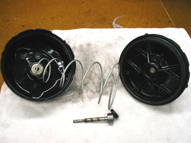

I took apart my booster to see what I could repair and had no problems getting it back together and running. You will need to make a "tool" to unscrew the 2 pieces and I made mine out of a piece of wood and drilled holes to match the 4 bolts and held the other end in my vice.
My seal around the shaft is corroded and did not seal well and it does hiss sometimes so I bought a booster from VB and swapped the seal to my original because the one from VB had a different vacuum nipple. I'll attach a picture I took of it apart.
You can see the round seal that goes on the end of the rod, that is what falls off causes the booster to fail.
Happened to me when I pushed the brake in and didnt have the MC installed, so I just glued it back on with a dab of rubber cement to hold it while I put it back together.
