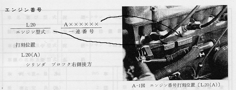

Cylinder block designation is stamped into a pad on the right hand side of the block, near the back, and up near the top surface. See the attached picture for location reference.
If its an early Fairlady block, then expect to see 'L20 A' as per the picture, but don't forget that Japan got the option of an L24 engine from late 1971, and you might even find an Export L26 or L28 ( even a domestic L28 is possible in the pile ).
