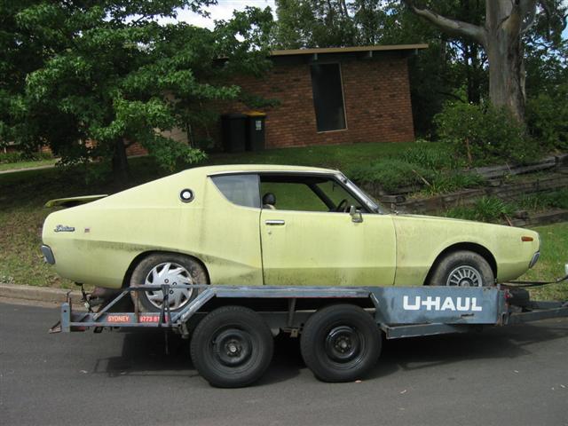

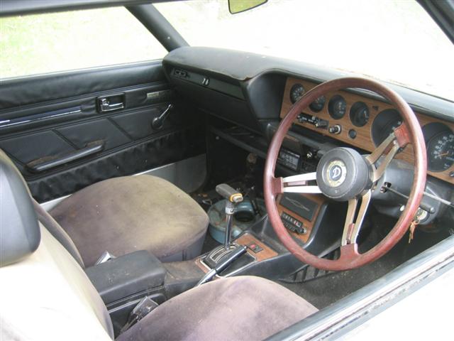

well,
she is a little rough (and well neglected over the past number of years), and home as we found out to a couple of families of mice. There are a number of rust spots coming through, front passenger quarter panel is a write off i think
but mechanically she looks very good, 65000miles on it (and it shows in the engine bay). Flushed out the radiator (coolent looked good, but a bit of sludge), there is a bit of sludge in the front brake resevoir, oil looks okay. Gave her a big wash, rinsing off most of the crap (and clearing out the boot, home to a family of mice under the spare wheel). launched a flea bomb to get rid of the rest of the nasties inside the car. will need to rip out the rest of the interior though just to be sure (only found 2 huntsmans so far!)
The carby on the car was from a 260c and apparently needed reconditioning as there may be rust in the fuel tank, so we replaced it with a 240k one we had lying around, put some petrol in the carb and tried to fire her up (by jumping from another car), unfortunately that didn't work, obviously some electrical gremlins and bad connections BUT THE TAIL LIGHTS WORK! (so did the radio, hazards, dash lights (very dimly lit), headlights and high beam, the rest doesn't yet). Starter motor doesn't seem to turn, it cliks but doesn't crank. hopefully it is just a bad connection too..

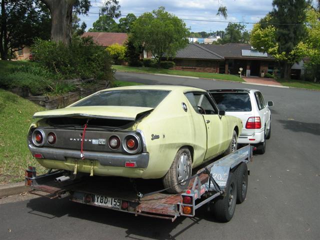

GT-R tail lights (i almost fell over when i realised!)
OK, now this is interesting!
Was the car badged a 240K GL or GT? It's a 1973 from your sig. What's the month of production and VIN (if you dont mind)??

The rear lights have obviously been modified to light both lamps as parkers :D and the owner had gone to extraordinary lengths to protect the interior by laying extra carpet under the original carpet, and in places, stitching more carpet ontop in high use areas. They even fully dismantled the seats to put seat covers on them (i thought they were velour until i ripped them).
Shame it was left to go to pot after he died, it would have been quite an exceptional car otherwise!

What's more interesting is those tail lights! I thought perhaps there would be a few other "JDM" things on the car, but apparently not. I guess a past owner replaced them, but it's still odd. Will you be disassembling this one too? If so, make sure to take lots of pictures of the lights and the markings on them. They should have a production date on them somewhere surely. That might help...
