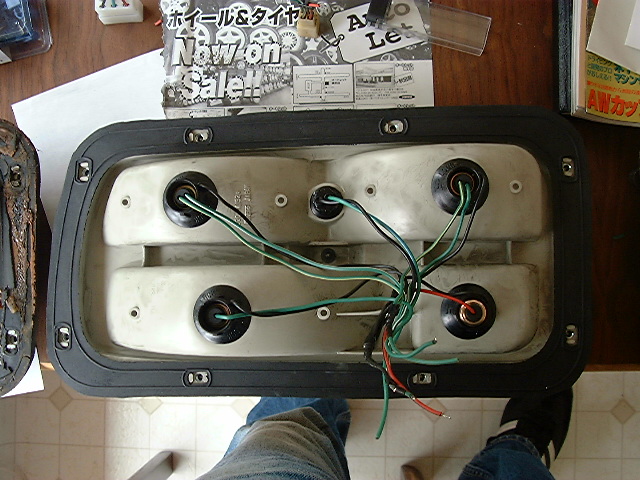

In the reply I am going to post the pic of the backside of a Japanese tail light. It is wired differently and has an extra (Parking) light in the top row where the US tail light has a plug stamped with the letter "P". So five bulbs total and starting from top left corner here are the wire colors:
Bulb 1: Grn/Yel, Grn/Wht, Blk
Bulb 2: (parking): Grn/Blu, Blk
Bulb 3: Grn/Yel, Grn/Wht, Blk
Bulb 4: Red/Blk, Blk
Bulb 5: Grn, Blk
So, in other words the wiring for the reverse lights is the same between them and us. So is the bottom left bulb. The top three are different. On the Japanese lights I was thinking of wiring the positive (Grn/Blu) wire of the Japanese parking light to the positive wire of the rear sidemarkers.
Now what about that extra Grn/Yel wire for the top two Japanese bulbs - Does anybody have an idea?

I'm glad I saw your post, and I'm sorry I hadn't noticed it earlier.
What you are asking, and the pictures you are providing are exactly what I was working on.
So, I'll share what I know and let you pick and choose.
The "extra" bulb between the two top bulbs is what in Japan is used in lieu of reflectors. Here in the US we rely on the reflectors in the lenses to reflect the oncoming cars headlights and therefore make the car noticeable. In Japan they decided to require the car to light itself up. The circuit allows only ONE side to be light up at a time, or if desired, both can be.
If you have an early 71 or 70 you will note that your console, to the right of the Rear Defog Switch has a hole for what people think is a fog light switch. It isn't. That's where the dual switch for the Rear Parking Lights was mounted in Japan, which is one of the bulbs you are seeing.
American cars do not have the wiring to support the switch, nor the lights. In fact, you won't find mention of it in the English Language FSM nor the wiring diagram.
The dual switch in the console was removed and replaced with a black square plug, so was the wiring, and the hole in the tail light was plugged with a rubber plug with the letter P on it. That's how American cars were sold. AFAIK only the Japanese cars had that feature.
So, you could wire it in sequence to your parking lights, or your brake light, but you wouldn't want to splice it into the turn signal as that is the reason for having the separate color lens for the turn signal in the Japanese (aka European) tail lights. Or you could just remove the bulb and put in a rubber plug to cap the hole.
Now, if you choose to do the latter, plug the hole since you don't have the wiring, I'll offer to buy those sockets from you, as I AM wiring the switches into my car and I AM looking for just those bulb holders and plugs.

Enrique,
You are correct, Japanese Zs do not have rear sidemarkers at all so the 5th bulb in their tail light does serve this purpose... What you've taught me (and it saves me a lot of time) is where the turn signal and brake light are merged in the US wiring harness (by the hazard switch) thanks a lot for that.
