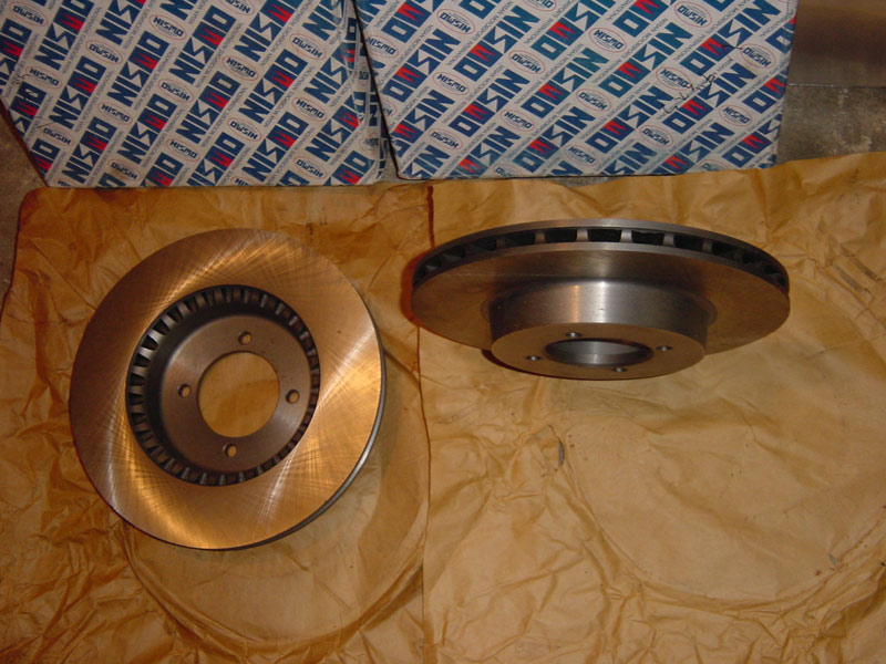

Here's a pic of my NOS discs before I fitted them to the 432R replica project car:

Thanks for the PICs this helps alot - re the rotors I was thinking about the Peugeot rotors all those years ago but went the 300zx with spacer path as I now don't have to get any new rotors machined once I had the spacers made.
