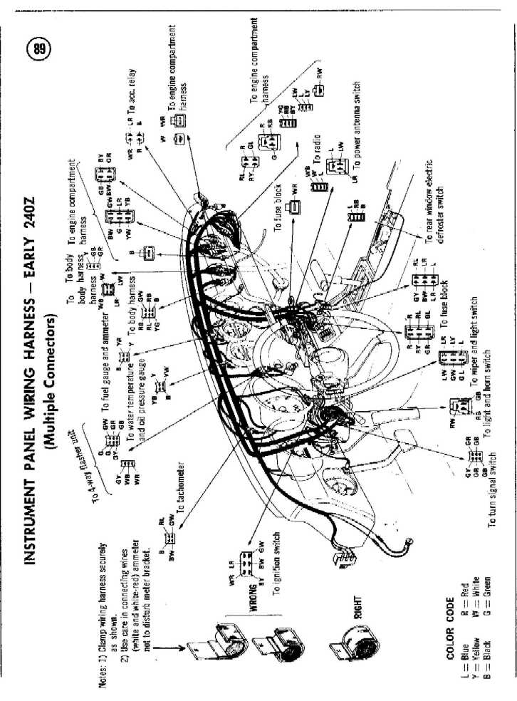

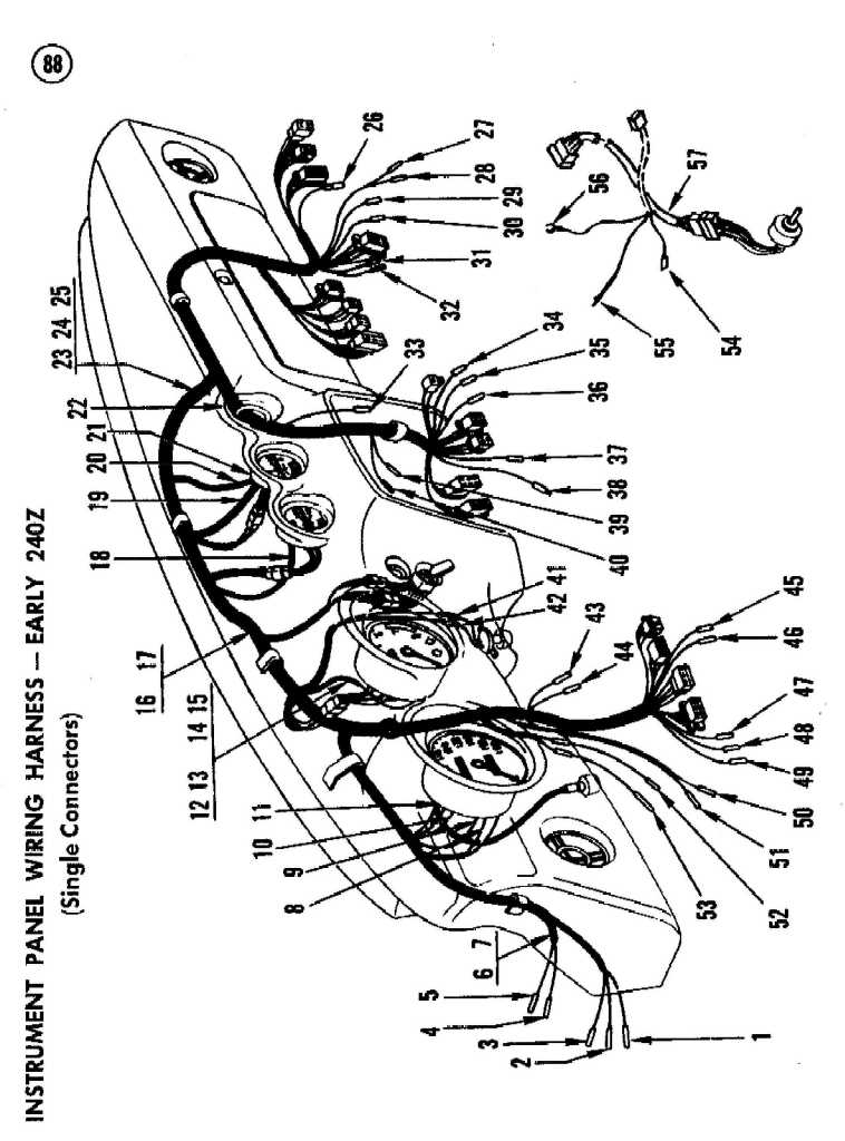

I have just installed the heater, blower assy, the dash, pedals and steering column. I am now putting in the console. I have plugged everything back in except for one pigtail coming out of the fuse box. It is a very short pigtail about 4" long coming out of the left(driver) side of the box. Cannot find a female connector for this male pigtail. What is this? Have I just lost a wire in the maze? Or, ??????
I originally thought it was for the lighter but I have the lighter hooked up and nothing is close to fitting this short wire. Anyone got any ideas on what this wire is for?
BK240: The production date is 2/71. It is a 4-speed w/o A/C. I have one bullet male wire that is about 4-5" long coming out of the fuse box on the left hand side. I do not know what this single (black) wire is for. I cannot find any female wire to plug this bullet into. What is this? Do I need to look for a wire or is it just a wire that is not used?

If you take the cover off your fuse panel and look at the pigtail on the left upper corner, you will see this short pigtail. Is this a spare for my car? :ermm:

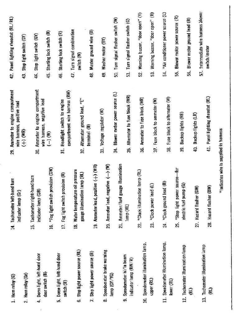

went out to my '71, the only single male wire coming from the left side is actually a white wire that has a black heat shrink sleeve on it. this attaches to a female white wire with a black plastic tubing surrounding it. from the wiring diagram this looks to be the line from the voltage regulator to the ammeter. i believe to confirm this you shouldn't get any reaction from your ammeter with key on.
try gently pulling back the heat shrink to verify this is actually a white wire. the only other single wire (except for the thick white/red main feed in the center) i have on my fuse box is the blue/white going to the cig lighter. on mine this is also covered with black heat shrink tubing.

Thanks for the info on the white wire (black heat-shrink). I will look for the matching female wire. I had the shell turned up on it's side when I put the dash in. I think the wire got caught up in the "mess". Now that I know there is a connecting wire, I will look for it. Thanks!
