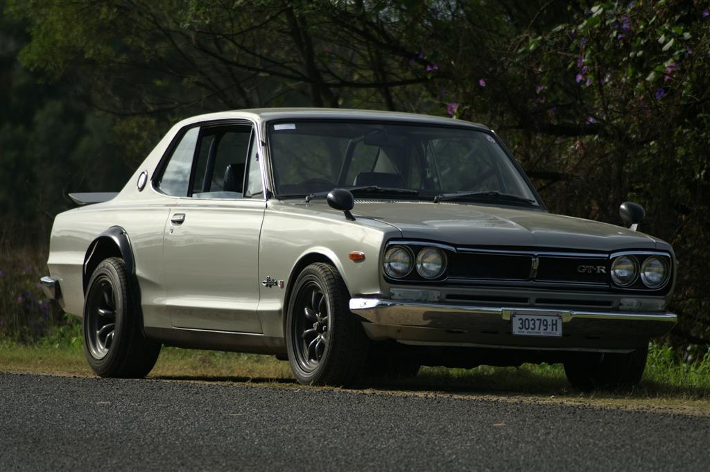

What Is The Avatar A Corvair With A Spoiler ?????????/
WHAAT? Geez Gary , I didn't know whether to laugh or cry when I read that! :laugh: ....but I can see what you mean. I quite liked the Yenko Stingers, but I'm sure Joe won't mind me throwing this in to clear it up for you.
Jim.
The Engine Looks Rough , What Is The Avatar A Corvair With A Spoiler ?????????/
What! dont you know a skyline when your looking at one! :ermm:
