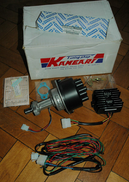

I have one.
The KAMEARI distributor kit includes an ULTRA electronic ignition unit. Ultra have been making electronic ignition systems since the late Sixties, and have a pretty good name in Japan.
The distributor body itself is a special casting, and has improved internals over the Nissan ( Hitachi ) Electronic distributor, but the Nissan cap is interchangeable. One of the good things about buying a new distributor is that it will of course be more accurate than an original ( often worn out ) unit with tens of thousands of miles on it.
If you live in Japan, then the Kameari kit is a reasonable price and kills more than two birds with one stone.

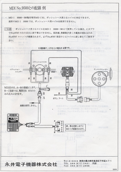

Basically you are looking at two different types of ULTRA ignition system there:
Ultra's CDI ( Capacative Discharge Ignition ) is actually a licensed version of the Lumenition system, with an optical trigger replacing the points in the stock distributor. You can buy this system on its own.
Kameari's Ultra CDI + Kameari distributor kit combines the Ultra CDI with Kameari's own distributor casting and improved internals - with it's obvious benefits over a tired stock distributor. This is the kit I have and which I pictured above.
The Ultra MDI ( Multiple Discharge Ignition ) system is another step up in ignition power that can be utilised in combination with the above systems if desired.

See the wiring diagram scans below, which I hope will explain the method of use and the combinations much better than I can myself:

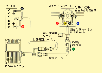

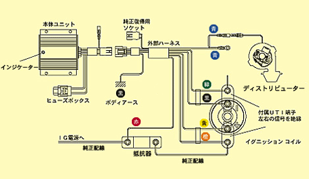

When we were talking about this last week I sent Alan's scans to a Japanese designer friend of mine & fellow car nut at Mazda in Yokohama. Even back in my Engineering school days I had a profound aversion for all things Electrical Engineering related and as I recall nearly failed my basic Circuits class. With that said here's his email back to me verbatim:
"Eric,
I think i figured it out.
The scan you sent me is not CDI or MDI. They are both hyper ignition Sytem by Nagai Denshi.
The one with MDI shows how to add MDI on top of Hyper Ignition System.
correct diagram for MDI is this
http://www.nagaidenshi.co.jp/IGNITION/9500_9600/haisen9500.gif
and CDI is this
http://www.nagaidenshi.co.jp/IGNITION/9800/haisen.gif
I looked at their website www.nagaidenshi.co.jp
and seems like there are
1.Semi Transistor
2.Full Transistor
3.Hyper Ignition System
4.CDI
5.MDI
1 and 2 are transistor ignition for point type ignition system.
Semi still uses points to pick up the signal but it doesnt use high current on the points. the transistor amplifies the voltage.... kinda like relay.
Full transistor doesnt use contacting points. It picks up the signal without actually touching the points, therefore more precise and no wear on the points.
these two are the basic ignition mods and less expensive.
3. Hyper Ignition System is for point type ignition system too. not sure what this is.
seems like this is an evolution of the semi or full transistor.
4. CDI is for point ignition car too. It uses capacitor instead of transistor.
5. MDI is the top of the line and its a multispark system. MDI works with newer cars as well as old cars.
for example this MDI kit is for Honda B16, B18 engines
http://www.nagaidenshi.co.jp/IGNITION/mdi_9680.shtml
I dont really know much about ignition system and never touched nostalgic heros so i might be telling wrong thing.
hope it helps a bit
-Yohei"
....."The scan you sent me is not CDI or MDI. They are both hyper ignition Sytem by Nagai Denshi."......
Eric,
'Nagai Denshi' is the parent company ( Oyagaisha ) that manufacures the 'Ultra' ignition systems and componentry.
The scans that I posted are the instructions that I received with the CDI and MDI systems that I purchased from Ultra. If you look at the bottom of the page it even says 'Nagai Denshi' in big letters.
You asked about the ignition system components on the PITROAD website ( scans from the KAMEARI catalogue ) and that's what I posted about. Not the full 'Ultra' lineup.
