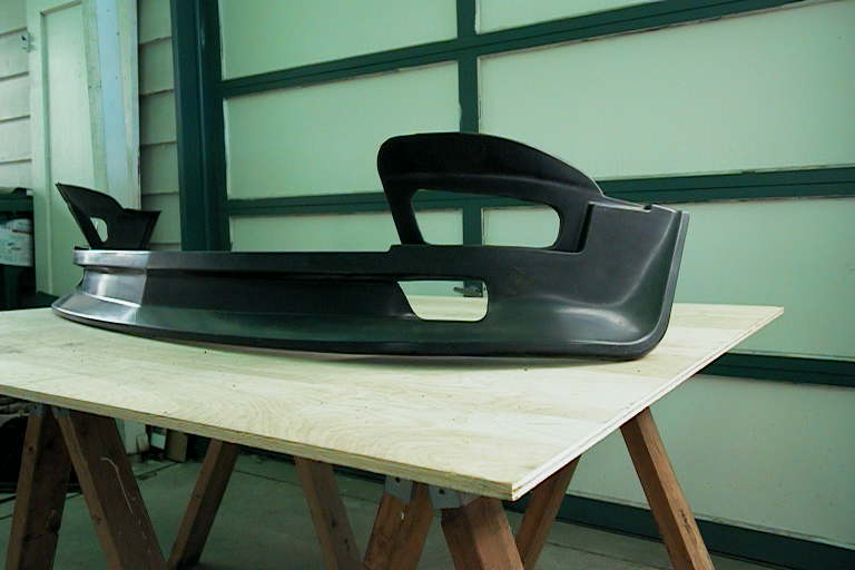

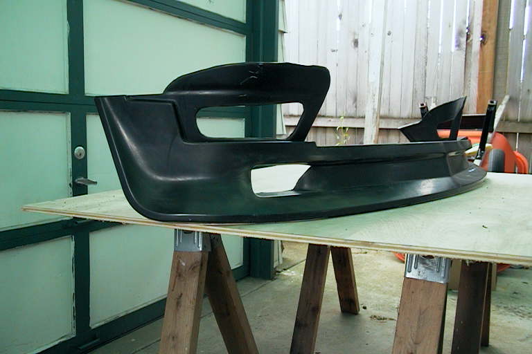

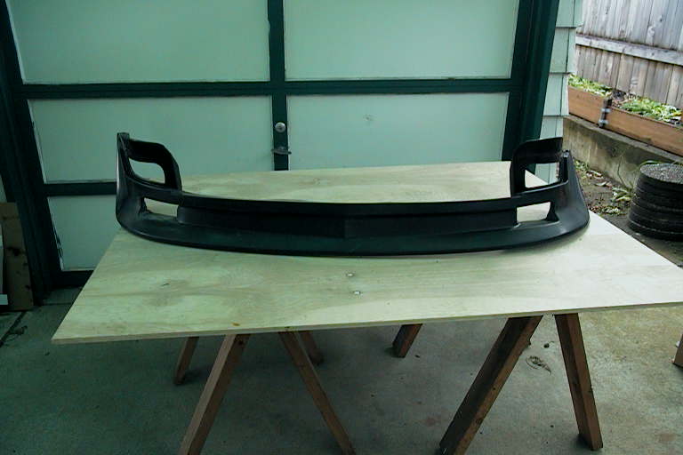

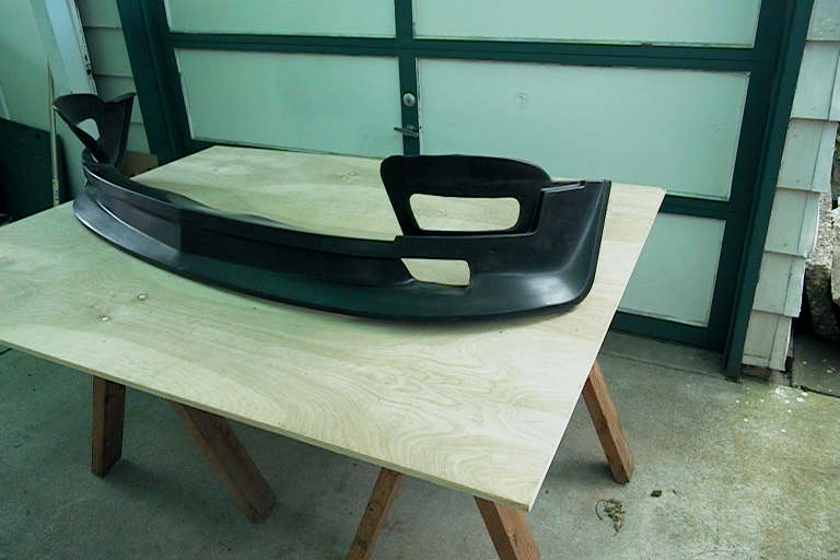

Hey ROOPZ, or anyone else
I've got a urethane air dam that came with my Z when I bought it from the P.O.
I never bothered to put it on since the car already had a fiberglass one on it, which I like the looks of a lot better. The urethane one has been sitting in the gardening tool shed for about 3 years now, never been used, and it's only been gathering dust.. So if anyone is looking for one I'd be willing to part with this one for cheap.
It's similar to this one on MSA site http://www.zcarparts.com/store/merchant.mvc?Screen=PROD&Product_Code=50-1411&Category_Code=7AD1
Attention: I do not know from where this airdam was purchased, all I know is that it is similar looking to the one in the link above. Like I said it's never been installed on the car, and it's not been painted, it's still the orginal black.
It has a slight twist to it from being hanging over stuff in the tool shed, but from what I saw there weren't any cracks or anything.. I'm willing to let it go for at least 50% less than what MSA want's for a new one, and probably less than that since it's not doing me any good except taking up space.
I'll try and post pic's tonight, and if anyone is interested try PM'ing me.
-Phil
Airdam Pic's
