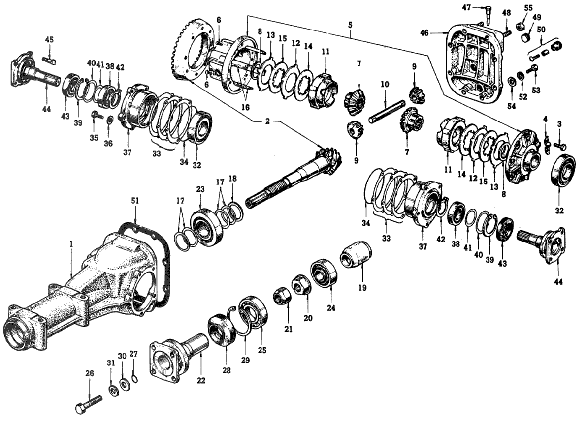

Exploded View R190 Differential
R190 Parts List

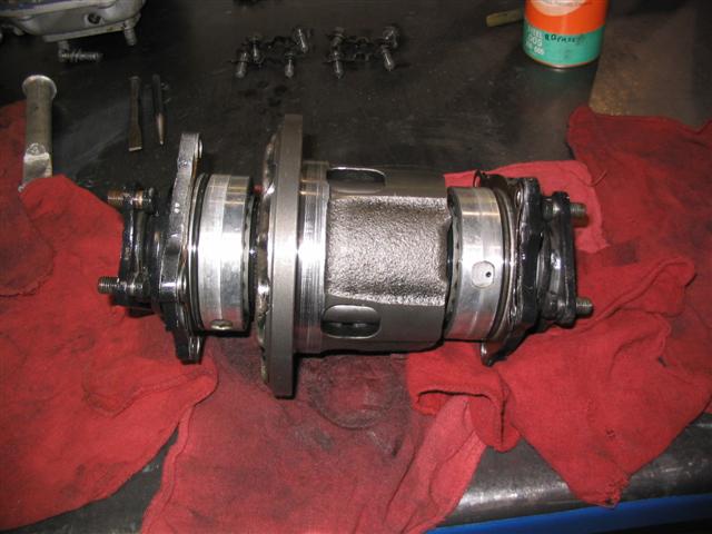

R190 LSD

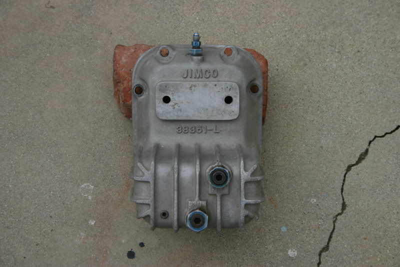

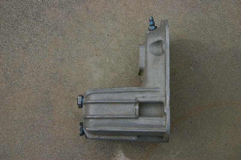

3rd Party back cover with extra capacity and cooling fins

Elusive bearing part: NTN 323/28C Nissan 09022-0010P
All bearing part numbers:
Part 23: Taper Roller Bearing 38120-61000 (Timken 32307)
Part 24: Pinion Bearing Front 38140-A0100
Part 25: Pilot Bearing Front 38335-A0100
Part 32: Taper Roller Bearing Side 09022-0012P
Part 38: Side Flange Pilot Bearing 38440-A0100 (Timken 107WB)
