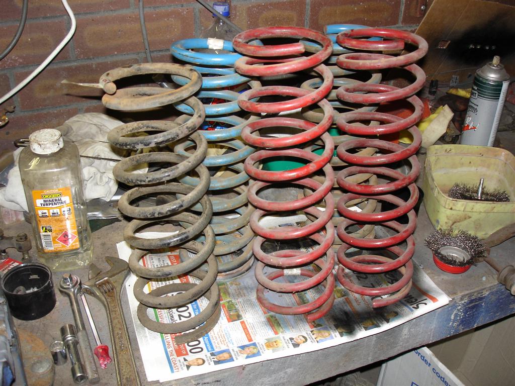

Heres a photo of some springs.
The black one on the left is from a 260z 2+2 front strut.
The 2 red ones are 240z front springs.
The blue ones are 240z rear springs.

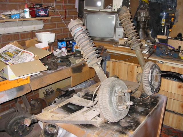

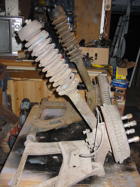

Heres a 240z rear strut (blue spring at the front of picture)
260z 2+2 rear strut. (at the rear of picture)
Most of the height difference is in the spring between the perchs, and also the 2+2 has a taller end mount thing.
