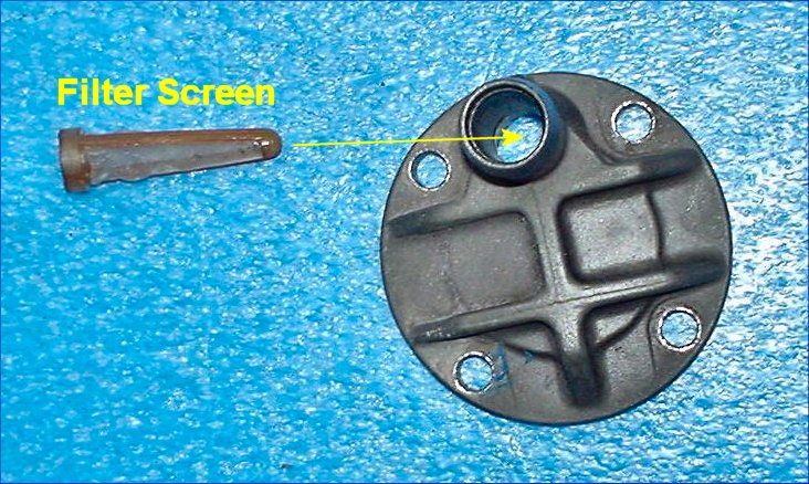

There's a little filter that goes inside the "Intake" side of the electric fuel pump. You have to pull the hose off to get to it tho...Following picture shows what it looks like. Last couple I looked at was clogged approx. 70-80% with tank crap. Carb spray works pretty good to clean it out if you use the little red straw...I'd use safety glasses also as that crap goes everywhere when you spray it...
