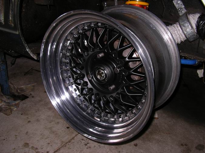

Oh............and as far as fitting 8" rims on your Zed go,
Ive been assured that you can actually fit an 8" rim on the front of your Zed,
The space you should have with stock suspension and stock body should be.......
4.5" (114.3mm) from hub face to spring perch
4.5" (114.3mm) from hub face to guard lip,
a total of 9" (just enough room for 8" of rim),
I think your pushing your luck if you take 114.3 distance from hub face to guard lip, i think you have about 112mm before you start touching stuff, ive measured and measured and then measured just to be sure, but folks have actually put 8" rims on their Zeds and its fit, with lots of clearance,
So what does this mean in regards to retail rims available???
Lets look at,
Performance Superlites
15" by 8" - 9.05kg (19.91lbs)
-4, 110mm
This rim gives us 110mm of Back-Spacing, and roughly 118mm of forward spacing,
Which means you will clear you stock spring perch but you will hit the guards, so this dont fit,
Performance Challengers
15" by 8" - 8.5kg (18.7lbs)
-9, 105mm
& a Forward spacing of 123mm,
Once again you will clear the spring perch, but your wheel will hit the guard, wrong offset,
Ive found no one who does the correct offset if you want to put 8" rims under your zed unless you go with Panasports, but these sucka's are about what it costs to go with ROH & Simmons, they arent cheap :-)
It's not the guard you hit on the front, it's that lower panel that hangs off the front of the guard below the bumper. And then it is only when the front of the wheel is turned into the guard. (ie turning right will interfere with the panels on the left side of the car)
If you were to trim this back, the wheels may fit. Or if you replace it with a front spoiler this may fix it as well.
The wheels/tyres with the -9 offset would probably only clear the struts by less than 10mm if using 235's. You would want to check this first if you were trying big stuff on the front.
