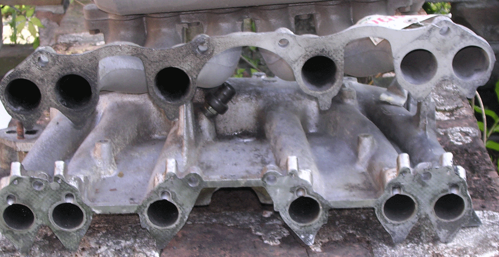

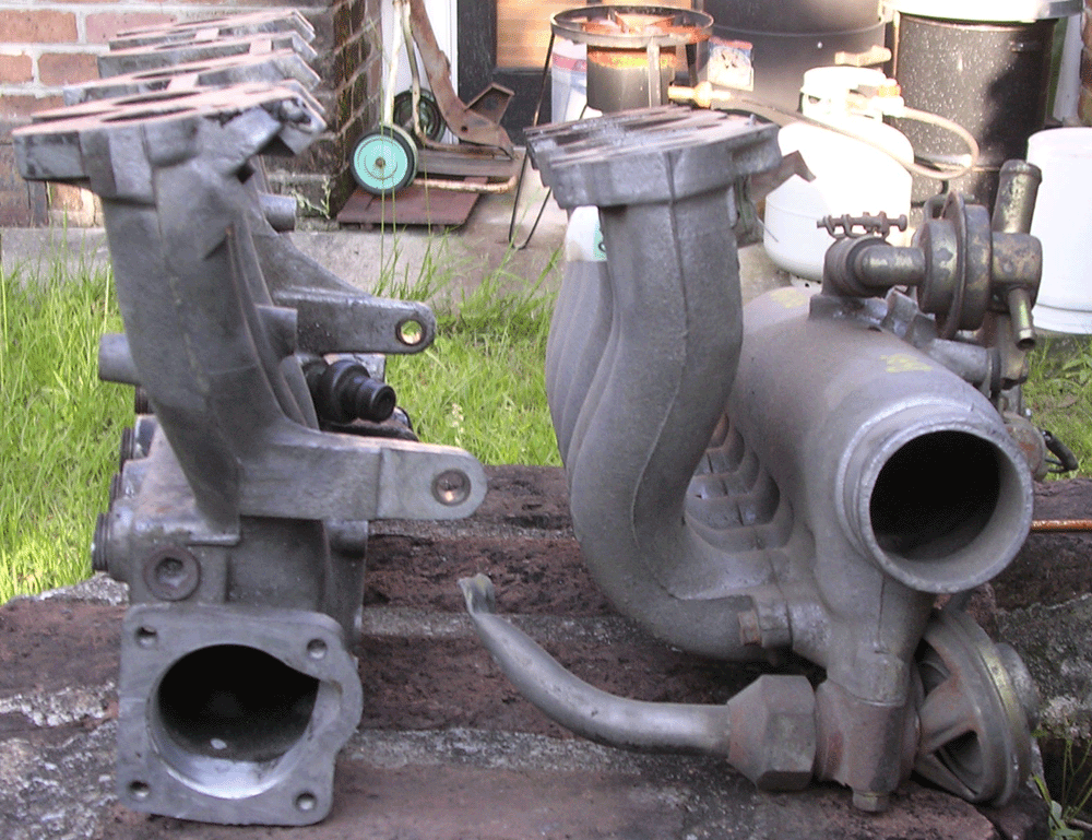

The mounting flange is not the issue-the manifold will bolt right up, the issue is the injector bosses.
If you were to use the N42 flange, you would also need to enlarge the intake openings, the Maxima runner has an approximate inside diameter if 1&7/16" but the Z intakes have an approximate inside diameter if only 1&1/4"
The runners for the Maxima Diesel are about 9" long (not counting the plenium) the Z runners are about 7" long to the plenum.
Here are a couple of pictures of a Maxima Diesel manifold and a 280Zx Turbo Manifold.
Yes, I did enlarge the opening on the 280ZX Turbo Manifold for a larger throttlebody...
Will
