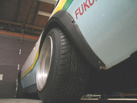

Now, as far as I know for the '74 240K the widest tyre was 175. That means 225 is the widest you could go... You could probably argue 185, and that's still only 235 - which would fit on the 8.5 and according to Yokohama you can fit that onto the 8.5 without too much stretch.

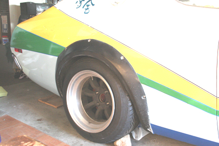

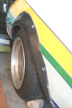

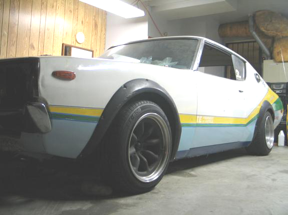

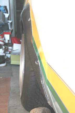

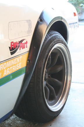

I've got 14x7.5 front and 14x9 rear and with about zero camber they fit just under the flares. When I lowered it the negative camber brought the top of the wheel in more (and the bottom out more) - I'm guessing you'd install a camber kit too (or do the modification 440k has details on (if engineerable!)).
