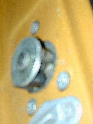

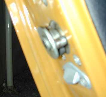

These are not the best pictures but hopefully they'll illustrate what's being discussed. Sorry about the focus, it's darn near impossible to focus in the dark!
If you look at the 2 "lobes" of the latch, you'll note that one of them has rubber on it. At least on one that hasn't lost it's coating.
I think I erred in saying it's the first lobe, it's actually the one in the "6 o'clock" position.
Hope this helps.
