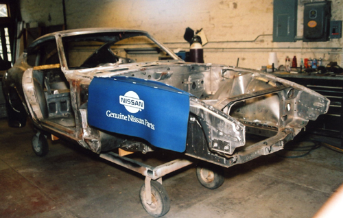

July 14, 200520 yr comment_130710 I doubt it's a 1000 lbs ... When I had it stripped - on jacks - I could lift the front of the car with ONE finger. The rear was a pretty easy lift as well, could probably hold it at least a minute on my own I'd say. Anyway, we were 4 (non body builder) guys carrying it onto a truck when I needed to get the Zed to a workshop. Wasn't much of a sweat. The guy upfront carried the car pretty much all by himself once it was hoisted onto the truck. Let me tell you - he ain't Hulk Hogan Here ya go. Link to comment https://www.classiczcars.com/forums/topic/16570-weight-of-body-shell/#findComment-130710 Share on other sites More sharing options...

July 15, 200520 yr comment_130776 I would guess mine weighed about 450 lbs totally stripped. I could lift the back by myself so a buddy could put a dolly underneath no prob (72 240). Link to comment https://www.classiczcars.com/forums/topic/16570-weight-of-body-shell/#findComment-130776 Share on other sites More sharing options...
