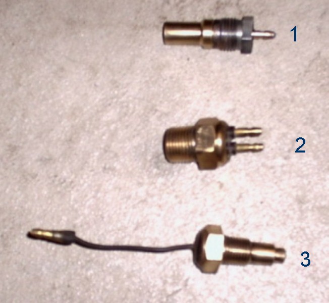

February 10, 200619 yr comment_155474 marcia500, are any of these the item you're looking for? #1 is a 'thermal transmitter'. It sends the signal to the temperature guage. I don't think that's the one you want. #2 is the 'thremal switch' which is similar to what Fredzed was looking for when he initiated this post, but it's the 2 prong US version rather than the 3 prong Canadian version. #3 I don't know the name of but your description makes me think it's the item your're looking for. I recall that it came from a ZX parts car and it's an item not used on my 78 280Z or my 79 810. I sent your husband an email with the same picture. Link to comment https://www.classiczcars.com/forums/topic/16600-this-switch-is-a-bitch/#findComment-155474 Share on other sites More sharing options...
