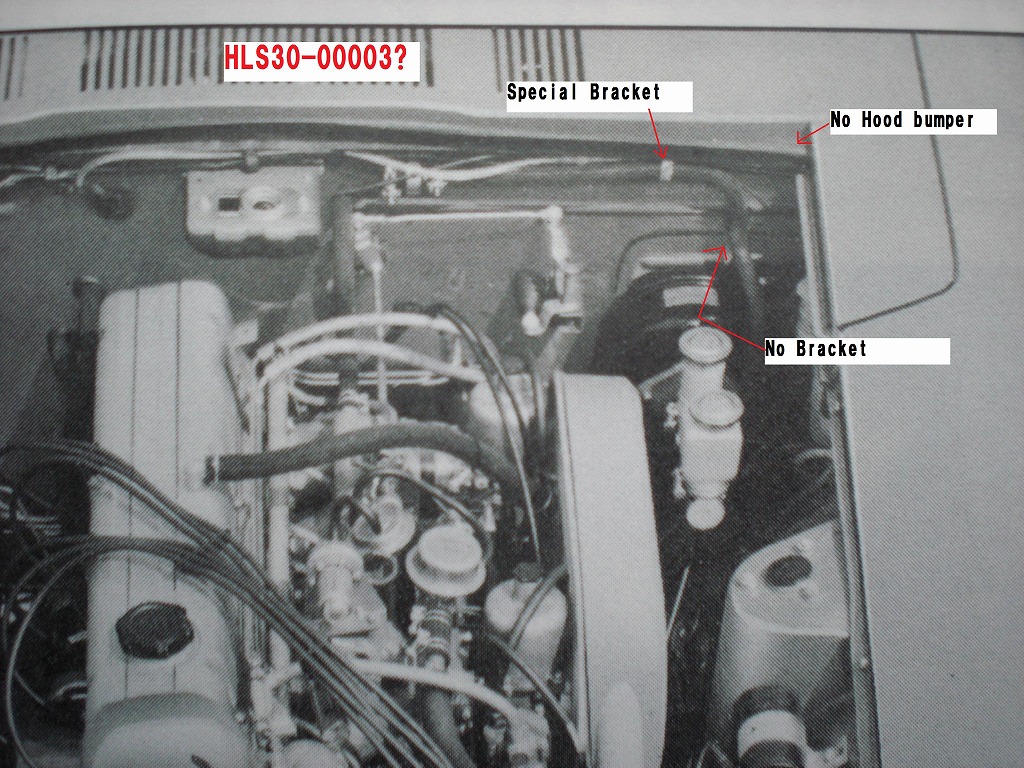

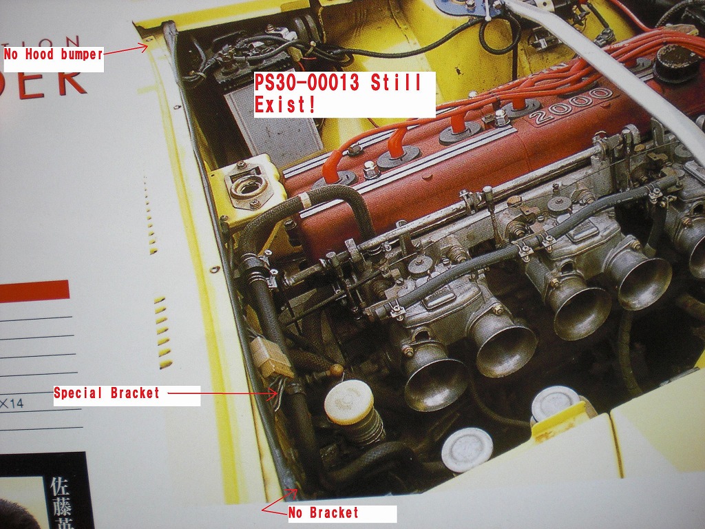

One of the big reason is , the bracket for the master vac hose under the chassis number.
This 00002 has it, but if you look really carefully into 1969 cars( I do not know the VIN but cars like on the manuals) does not have this bracket.
I saw HLS30-00013 does not have this bracket but it has a special bracket near the window washer tube.
PS30-00013 is still exist in Japan and it is the same, no bracket but a special bracket.Even no hood bumpers.
Yes you may say the bracket was welded later, but....

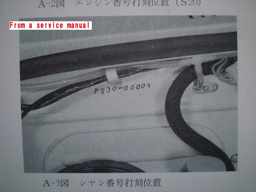

And the chassis number, it is too neat to be an early car.
See the picture of PS30-00009 , this is a good example of super early car.
No bracket for the master vac hose and not-neat numbers.
Hi Kats, I think all early production S30s must have the different bracket that you show. Here are pictures of the ones from HLS30-00032 and HLS30-00237. Maybe some early 1970 production cars too. I wonder what the cutoff was?

Thank you Mike,
That helped me a lot, quite high number of early cars do not have the one,but special one.Very nice clear pictures,thank you.
So these bracket can not be the good sign of super early car.

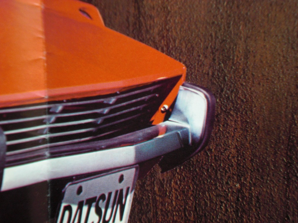

One more good point of super early car,is the side bolt of a head lamp case.
I want to know how many cars do they have this bolt?
See this picture.
kats
I agree Kats, I have not seen production cars (sold directly to the public) without the hood bumpers or with the side bolt attaching to the headlight bucket.
