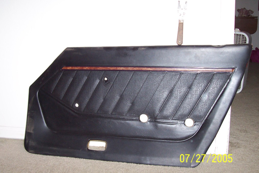

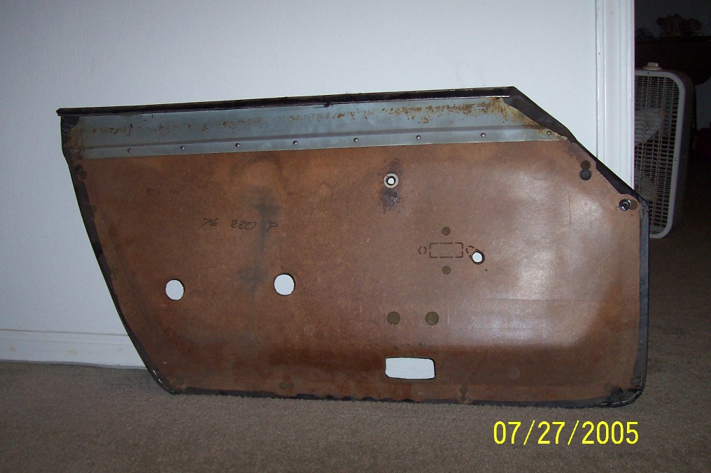

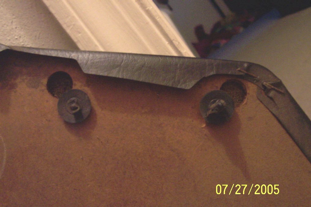

Attached are the front, back and close up of the back of the passenger door panel, **edit* 76 *edit** 280Z Coupe
If you don't see a similar view when looking at yours from the inside of the car, i.e. door latch still mounted then remove those items.
Pic one is the front view. Also shown is an invaluable tool that I use for getting between the door panel and metal door frame, to assist in removing the plastic rivets that keep the panel from rattling.
Pic two is the rear view, missing some plastic rivets.
Pic three is a close up of the plastic rivets.
