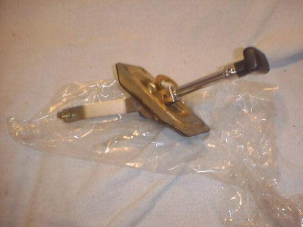

OEM Surplus has two of these left. They are the complete shifter assy.for an automatic up to 73 and they are new. The msrp is something like $272 but he generally sell stuff for 25% so it would cost you about $70 or so.
http://www.oem-surplus.com/nwp/index.htm
Right click on the page and look in 240Z, 260Z, 280Z (1970-1978)
