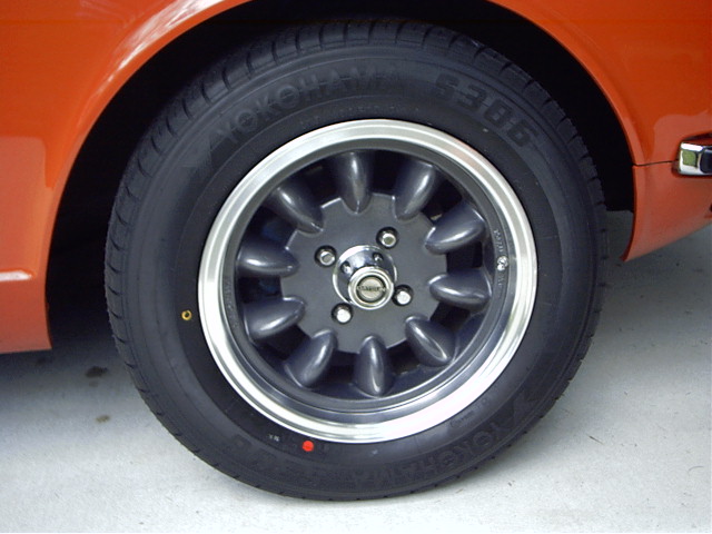

Is that your car? It looks sweet! As far as max tire size, ask five people and you'll get 10 answers. I have run as large as P245 wide (P245/50/15). I have seen as large as P295 on a Z that was tubbed out. I heard a rumour that a guy in the Dallas Z club was running P325 on his Z (he had gotten a 'turtle' conversion that is popular among those with no style of thier own, you know; the one where the tires stick out about a foot outside the fenders). The height of the tire depends on the rim size you are running. I run a standard 14" rim, therefore I run a 60 rated tire. Total size for me is P215/60/14. Now if I went to a 15" rim, I would run a 50 rated tire to compensate; ie P215/50/15. Those guys running 17 or 18" rims have to go with a 20 or 30 rated tire. The larger the rim, the lower the tire height has to be to compensate.

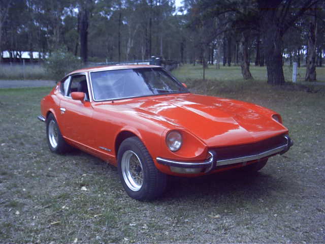

It looks like there are a few downunder members of this z club. I've been on the hunt for a 240 for about 6 months (my standards are high!). I recently discovered a great Australian site for parts and cars at http://www.ozdat.com. Check it out, there's a nice orange 1972 for sale at the moment in NSW (pricey at $12k but you could knock him down I'm sure). I ruled it out because it had been converted from auto to manual and I'm a bit (lot!) of an originality fanatic. In fact... when I spoke to the guy he said that he'd just put minilites on the car so there you go. Just to whet your appetite, here's a pic (with the old hotwire mags)
