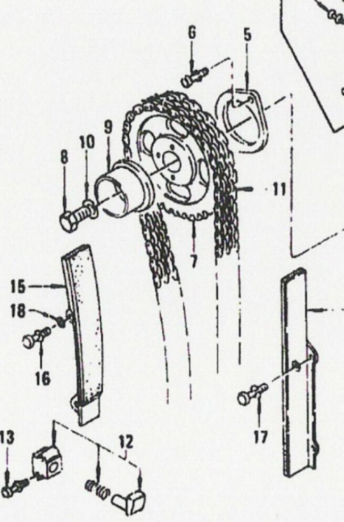

As I recall you can take off the valve cover and easily see the offset cam lobe. However, before you do that, are you sure the fuel is actually getting to the pump? Since the car sat for so long you've presumably drained the bad fuel, blown out the lines with compressed air, and added fresh fuel.

If you dont want to take the v/c off, shine a light in the fuel pump hole and look at the eccentric on the front of the cam. If you can rotate the engine while looking, you can examine the eccentric on a complete rotation. You could rotate the motor till the "bump" on the eccentric is towards the pump hole, then when you install the pump you can kind of feel the arm of the pump contact the eccentric. You have to push kind of firmly against the pump to depress the lever and slide it onto the studs in the head.
Hope that makes sense and helps you somewhat.
