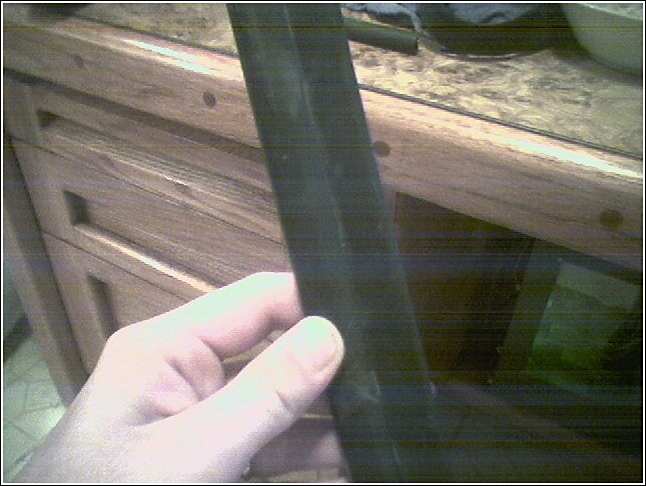

One of the most irritating things about an old car is often the hardened, brittle rubber weather-strip. This stuff is absolutely neccessary if you ever drive in the rain and don't like colonies of insects making a home in your beloved old wreck. These pieces are almost always available from the OEM, but at a serious premium. If you add up all of the parts they sell for your car, a 10k 'disposable car' ends up costing six figures or so. Then there's the aftermarket suppliers who sell those foam strips and look alike rubber. The foam is crap, but some of the rubber appearing on the shelves is quite an acceptable substitute for original, especially for those rare old cars whose manufacturer hasn't made replacements for the past twenty years.
Unfortunately, some parts aren't available at all or only at great expense. This was the case with the rubber window 'squeege' on the project 280Z. Yes, 40$ (It is 40$, right? I'm not substituting for some cheap stuff here, am I? ) is a great and unneccessary expense when the cost of the entire job is calculated. After much crinkling of the forehead and skull-scratching it was left to rot further.
While searching the hardware store for some 'take over the world' type equiptment I stumbled across some odd rubber strips used for some sort of flooring. There were several types hanging on a rack with various cross-sections and among them was one with a flat, beveled plane that closely resembled the 'squeegee' on the door windows (the entire cross section resembled a lowercase 'd', with the c part open at the end). 'Eureaka!' I cried, causing some fellow shoppers to eye me with sidelong glances and edge towards the door. The strips weren't perfect, they would definitely require some cutting but they were only four dollars for ten feet! That kind of savings was irresistible. Even a failed attempt would leave some of the material for a future need.
The first order of buisness was to cut the stuff lengthwise to remove the 'C' shaped channel that curled over the flat area. Lacking a long straightedge I used a footlong ruler with the predictable less-than-perfect results. No problem, the cut egde would be below the window trim and invisible to all but the most determined and inexpert of car thieves.
Next came the more difficult part, attaching the rubber to the stainless steel trim. The first attempt, using contact cement, was a dismal failure. It separated easily leaving gooey strands everywhere. Though it may not have been left to dry long enough, this probably wouldn't be the best way to attach it. What can I say? You never know until you try it... Nissan used staples. Not really something possible here, as crimping the ends will probably prove too difficult without damaging the trim in some way. Screws might work if the tips could be trimmed in such a way as to not interfere with the window or prevent the trim from snapping back into place.
So, in went the screws. First, a hole was drilled through the original metal strip, the new rubber and the rail using one of the old perforations from Nissan's super-staple-gun. The self tapping screws held wonderfully but were, of course, too long to allow the door rail to snap back on. Not a problem. Using a screw to tap out the threads and backing it out allowed a 'shortened' screw to be placed. The screws were shortened using a pair of large wire cutters. It took a few tries and seems to be something of a hassle but is a vast improvement over glues and epoxies. It gives you that SOLID feel, that's always so great when you've put together something. After the strip is back on the car it's time to trim it to match the original along the other stainless parts. It doesn't look exactly like the original but it's a far sight better than the crumbling crap that's been sitting on the car for the past thirty years.
You may want, if paranoia strikes, to seal it with silicone or somesuch at the bottom to prevent water from dripping down but if you screwed it in properly without warping the metal excessively this shouldn't be a problem. I can't say what the strips I purchased were made of but they seem to be a flexible pvc type. They were hanging on a rack at the Home Depot right at the end of the flooring isle. I'm sure there's several types that would work at home improvement stores everywhere at a similar savings to the factory replacements.
After performing this minor surgery and looking over the leftover section I cut from the liner I became curious and ran outside with a small section of it. Lo and behold, it was a perfect replacement for the rubber that surrounds the bottom of the rear window louvers, which had also become rotted through the years.

Hey Sideshow, could you find/supply the Home Depot part or item numbers? Having that number to refer to would eliminate any wierd looks and head scratching from the guy/girl at Home Depot. Also, do you know the screw size you used, like a #4 or #6? I'll second that request on some pictures!

This was in the dark, but you get the idea. Oh, and you can use any small self-tapping screw. drive it in first (after drilling hole of course) then remove and cut most of it off. Leave just enough to hold the strip in place and not interfere with replacing the trim on the door. Space these fairly closely and take care not to overtighten because the rubber will warp around it. Also try to get as steep an angle (against the windshield) as you can.
