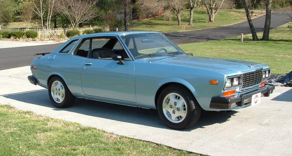

I was just playing around, just because your probably one of the closest ones to me in the club. So you just moved there? from where? glad you missed all the terrible fires a couple of years ago..
** and by the way thats a beautiful 810**

We moved here from Fontana after having lived there since 2000. Prior to that we lived in Upland for three years. The 810 is okay for a daily driver which is how I use it but some of the cosmetic parts are really hard to find. I've been looking for a good pair of inner windshield pillar moldings for two years now with no luck. I've only seen about ten or so of them in the junkyards in the 2+ years I've had mine and amongst those only three 2 doors one of which was my parts car which I sold to them.
