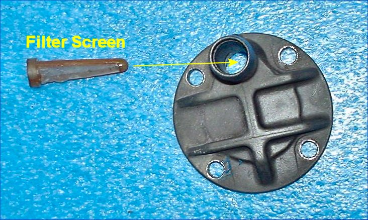

Do a search on "Alternate Fuel Filter" if you want to read up on doing a filter prior to the electric fuel pump. There is a small filter just inside the inlet side of the fuel pump (See picture) and it can be a PITA to get out sometimes.
