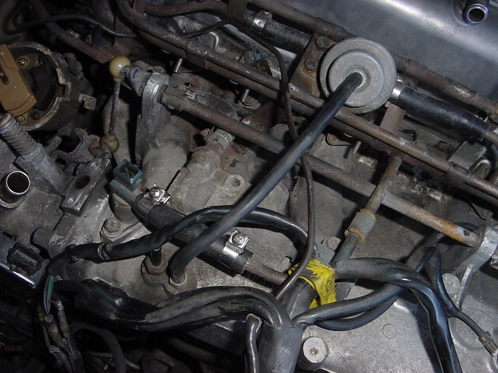

The fuel pressure regulator is on top of the intake, and in the middle of the fuel rail (oval-shaped tubing connected to the injectors). It is around cannister with a vacuum hose on one end, and two tubes coming off, one is bent, that are connected to the fuel rail with rubber hoses.
They were about $40 at AutoZone. It's not too hard to change it. Just takes time to take all the parts/hoses/etc. apart. Also get yourself some 5/16 inch fuel injection hose and 5/16 FUEL INJECTION CLAMPS- not those cheap water hose clamps!
See the picture. It's the round thing in the upper-right corner.
