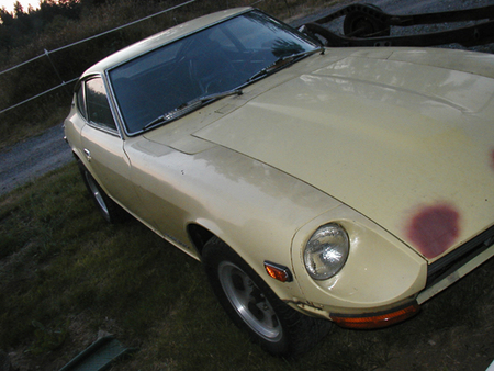

This car is 300 miles away, so I will have to travel to assess it. Here in the Pacific NW, there's no road salt used, so rust is a little less common than elsewhere. This car looks to have lived in these parts all its life, and the only obvious spots in the pictures I have so far is the two front fenders. But I haven't seen under the battery, or the hatch tray yet. Frame rails and floors are reputed to be solid. (We'll see.)

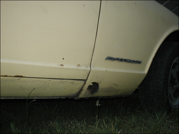

A couple other pictures...
The piece of fender that you have a rust hole in you can get a cutting disc for a grinder and grind that piece off and Victoria British sells that piece it's about, $40.00 Also check your frame rails for rust(it's a pain in the arse).

When you get under that fender you'll probably find a couple of rat's nests of leaf and needle debris that's decomposing. That's what more than likely caused the rust to be so localized.

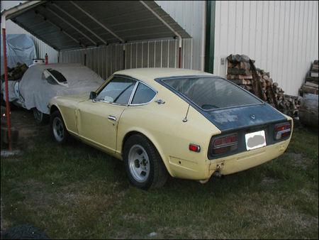

I'd also ask about the hatch. The side pillar emblem implies that the car is a 70 / early 71, but the hatch is from a later model (no vents).

From the first picture it looks like you should expect to replact that one drocker panel- at least. You could do yourself a big favor by getting it to a place to ateam clean the bottom, or at least blast out all the dirt underneath to see what really is down there. Maybe you could get the owner to do it & split the cost of that.
Yeah, I noticed that also. Didn't get much response from a previous post on that subject. (http://classiczcars.com/forums/showthread.php?p=141159#post141159)
Haven't decided what I'll do about that if I buy the car. Leave it be? Find a series I hatch? Add the series I vents to the existing hatch?
