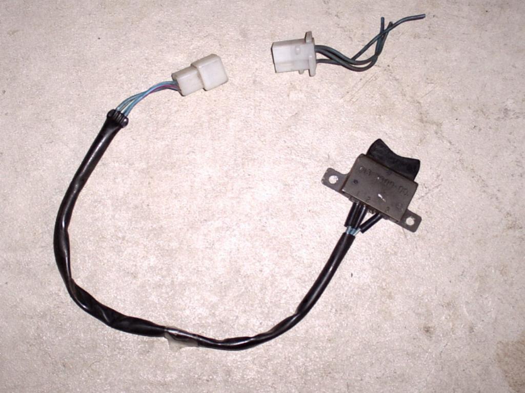

That is the switch. Not sure if that's the correct one for Tomo's car though.
AFAIK, the switch mounted above the right hand knob, that was operated horizontally was on the earlier cars, and the switch mounted to the right of the right hand knob and operated vertically was for the later models. Additionally the earlier switch was a "traditional" switch , i.e. rectangular knob with grooves that you slid to one side or the other, whereas the later ones were rounded a rocker style switch.
