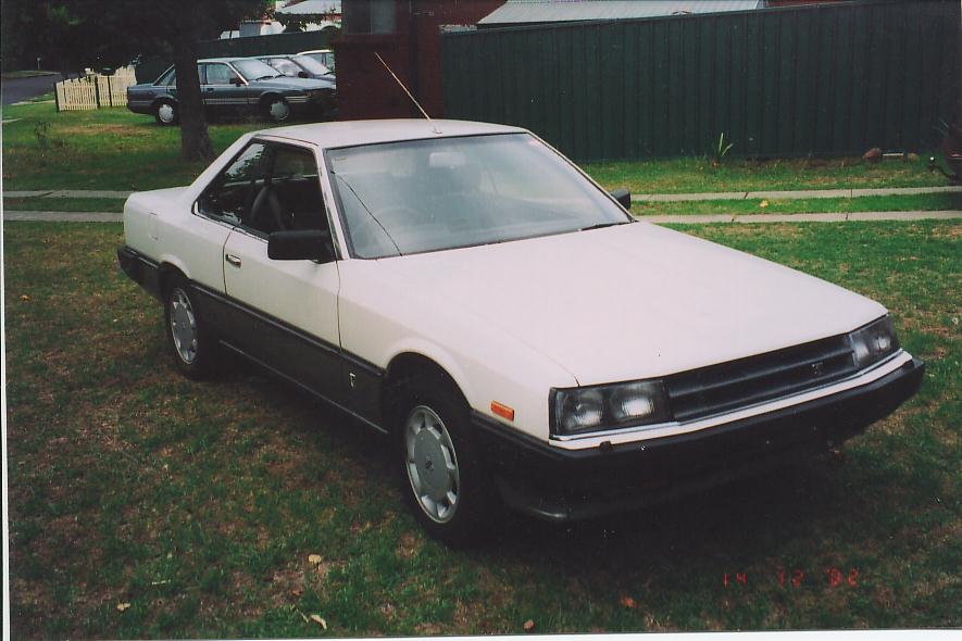

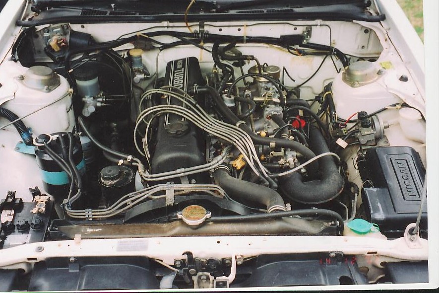

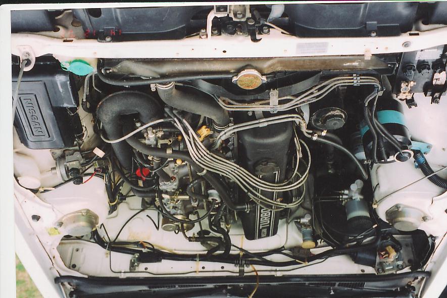

Thanks Guys,
I'm no spring chicken turning 56 this year, I have been playing with cars for a while now, but nothing like I'm entering into now.
Below are pics of my HR30 Coupe and Engine Bay so you can understand why I am now on this forum.

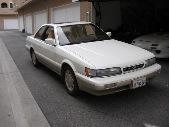

That does look like an L6 version of the Infiniti M30. Ours all had an electric sunroof and automatic trans with a VG30E or it might have been a VG30DE. Weren't they known as the Nissan Leopard in some parts of the world? I can only answer #4. The turbo gearbox (BW T5) had different ratios than the na trans. You can check all of the diferents transmission ratios here: http://www.geocities.com/z_design_studio/transmission.html

I like that grill on your car. Unfortunately I still don't recognize it's counterpart here in the U.S., but I bet that SBlake did and is probably drooling over your pic. Quick question for you, what are those little wedges on the top front of the bumper? I'm not familiar with them.
Enrique

I'm no 'real mechanic' by any means. Just an automotive hobbyist. Whatever that is. The M30 looked like this. They were only here for 3 years 1990-1992 IIRC. Ours was a 1991. Had a lot of problems and we traded it for the J30. This is not a picture of the one we had but it is on with the exact same appearance.

Enrique,
They are "Headlight Washer Pods". The pump mounts in behind and centre of grille and controlled off the dash by a rocker switch & all the tubing is in the back of the bumper, but unfortunately, this pump is the first thing to go when mounting front mount intercoolers..
