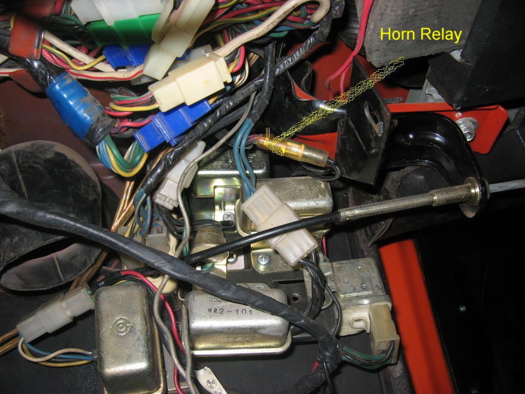

Tell me more about this horn ground.... I do not have a ground wire connected to the steering column. I did not have a horn prior to the resto work. (I did not have brake lights either! Drove it all the way from Salinas, CA to Salem, Oregon without a horn, rear view mirror or brake lights. Oh yeah, no license plates, either! Fixed everything but the horn.) Can you tell me the color of the wire, type of connector, etc. for this ground? It must be fairly large because the bolts are 6mm.
Hi, ZSaint,
The horn relay on my '73 is mounted up high on the passenger side kick panel, amid several other relays (see attached pix, pardon my crude label!). One pic shows the horn relay surrounded by the other relays, the second pic is a closeup of the horn relay. It has 3 wires: green/black - from horn button on steering wheel, the connector is labeled "S"; green/red - battery, the connector is labeled "B"; and solid green - to horns, the connector is labeled "H". I think the horn relay is mounted on the driver's side kick panel on early 240's.
On the steering column the green/black wire connects to a wiper that rubs against the backside of the steering wheel. When the horn button is pressed, it creates a path to ground through the steering column for this part of the circuit. If the wiper isn't rubbing against the back of the steering wheel the horns won't sound, a common problem.
A DVM set to resistance can be used to verify the wiring, disconnect both ends and connect a lead from the meter to each end. Should be 0 Ohms. Another simple test is to use a jumper to ground the horn button. If you remove the horn pad you will see a black wire screwed to the horn button. Use the jumper to ground the wire to a good frame ground. Normally this is through the steering column. If everything is connected properly and the relay is good this should sound the horns.
When I was troubleshooting my horn problem I measured a couple hundred Ohms with one lead of the DVM touching the center of the steering column and the other lead touching the frame. When I chased the threads for the steering column mounting bolts, the resistance dropped to less than 1 Ohm, and the horns worked.
Hope this helps!
