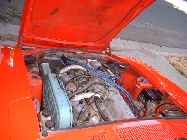

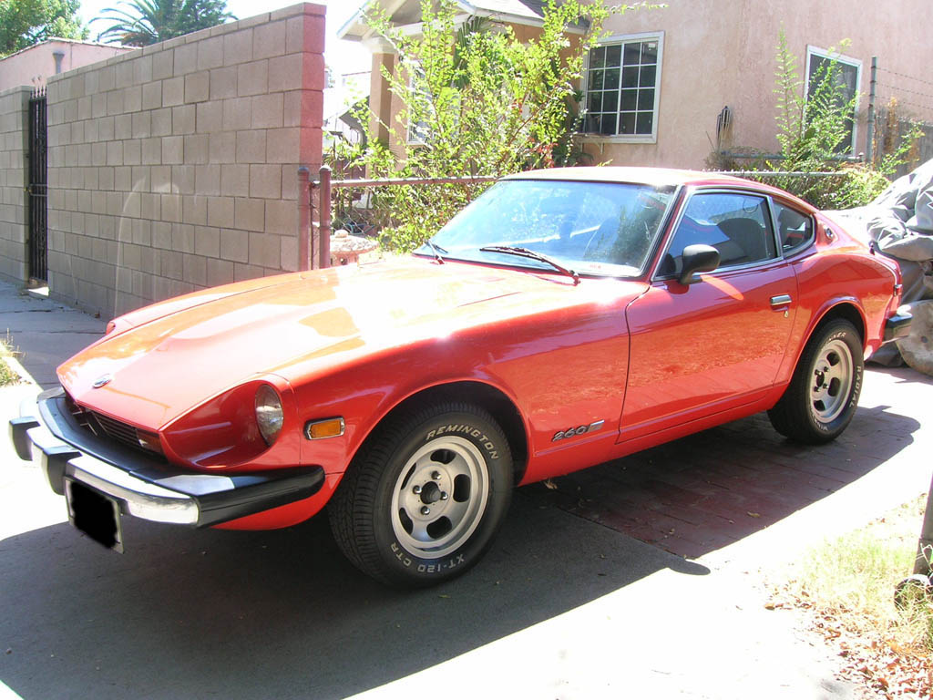

It looks to be good shape, but rust is our cancer. Check the frame rails and floorboards as they are common rust areas. And sense your California, 3k might be high for a non-east coast car (they're more rare on the east coast and rust belts, so thus the price is higher). I would try to haggle to $2500, don't pay more than $3000 unless the body is in perfect, and I mean mint, shape. It's a good idea to have a body guy or someone from this forum check out the car- some people have a nasty habbit of trying to rip people off by just covering rust spots with Bondo and/or paint. This doesn't fix the rust, it actually seals it in. Rust is like a bacteria and spreads, so if it's sealed in by paint of Bondo, it will just dissolve the car. You can sometime tell if rust has been covered if there is bubbling under the paint or rough patches that don't blend in with the rest of the coat.
Z's aren't the most expensive cars in the world, but they aren't the cheapest. They're getting more rare and the price is slowly climbing. It's true, if you spend say 3k on the complete car and another 8k on parts and installation, that would total 11k and for that much you could by a complete Z-rod already done and in good condition, no doubt. But for most of us, tooling on the Z is half the fun. And, you will save money if you can do your own labor.
I agree with jackbox that going to a muffler shop and getting a full 2.5" custom aluminum or stainless steel exhaust is the best choice, but it usually cost more than a pre-fab bolt-on system (I have heard some fitmit issues with MSA's kits). You don't want to have to get a custom-made header though, those usually price north of $600 and take a long time to make.
The main deterent to this 260 is it's automatic. A manual swap can be done, but it's pricey on most occasions. I would say if you can haggle the guy to around $2500 go for it, otherwise keep looking for what YOU really WANT. Don't settle or you're end up kicking yourself in a few months, or when you're dropping that manual trans in and plunking down the cash for it. Just a thought.....

So what is it about this specific car that makes you want it so badly anyway?
I ask because for 3000 dollars, theres quite a few Z's to pick from, in as good condition as this one, yet maybe has the manual tranny already, or early carbs, or perhaps a 240 or early 260 with small bumpers etc etc..
i spent about 2-3 months looking for the right Z this time around, and Im happy with it because its just what i was looking for..all my previous ones were more "spur of the moment" buys out of the local paper..
just a thought as I was browsing ebay Z's for sale this morning.
dont settle :)

jack, to answer your question:
"So what is it about this specific car that makes you want it so badly anyway?"
i think it's the appearance of the car
i think i've developed an emotional attachment HAHA
to the orange color and even that lines of the big heavy bumpers
and original rims
you know, it like when you see a car and you say "that's me! that's my car! that's my style!"
i'm glad you forced me to answer that question
i've gotta put it in perspective
i guess the question is am i willing to pay a premium for this SO CALLED emotional satisfaction?
for example, there IS another car that is a better value:
a 1971 240z (better carbs, stick) it great shape with expensive rims
and really babied by its owner (great stereo, the whole 9 yards)
for $4000
but it's BLUE (and a nice blue too)
and for some reason i'm stuck on the orange
i feel like it would somehow be sacriledge to repaint it orange
like bad car karma! like the car would hate me!
of course i would think twice about ripping the engine apart to improve it
kind of a hypocracy, eh?
crazy huh? i've really got to stop all this silliness :stupid: HELP!
