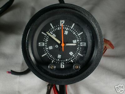

Noticed that the clock seems to have extra markings and third pointer (hours minutes and seconds I presume). Has this been mentioned before.
[quote name=Mr Camouflage
Yes, this has been mentioned before. The clocks are very neat. I believe that they were made by Citizen. There are a few types and they are known as "rally clocks". Just make a search and you will find quite a bit of information here about them. The rally clocks were offered in the Fairlady ZL, Fairlady 240Z, and Fairlady Z432. Basically, it was not equipped in the Z432R, or S30-S (both coupe and 2/2). Thus, they were never offered for an export vehicle. However, I have heard of a few US market cars having them during the period. I don't know how they got equipped with them, but the owners were definately lucky if this was not a myth.
The early clocks, 70-73, had a stopwatch function. Thus, the second hand and extra marks. This clock required an oscillating box which was located in the glove compartment. This is a very cool clock, and much more rare than the later clock.
The later clock, 74-78, is known as the "Calander clock". I think this is a slang term due to its function, but many people call it by calander clock. It is still a rally clock. It has a second hand, extra marks, no stopwatch function, but it has the date. I found one a few years back and I love it. There was no need for modification to install it into my 260z.
Take care and if you have any questions about them, I will try to help.
-Ben:)
