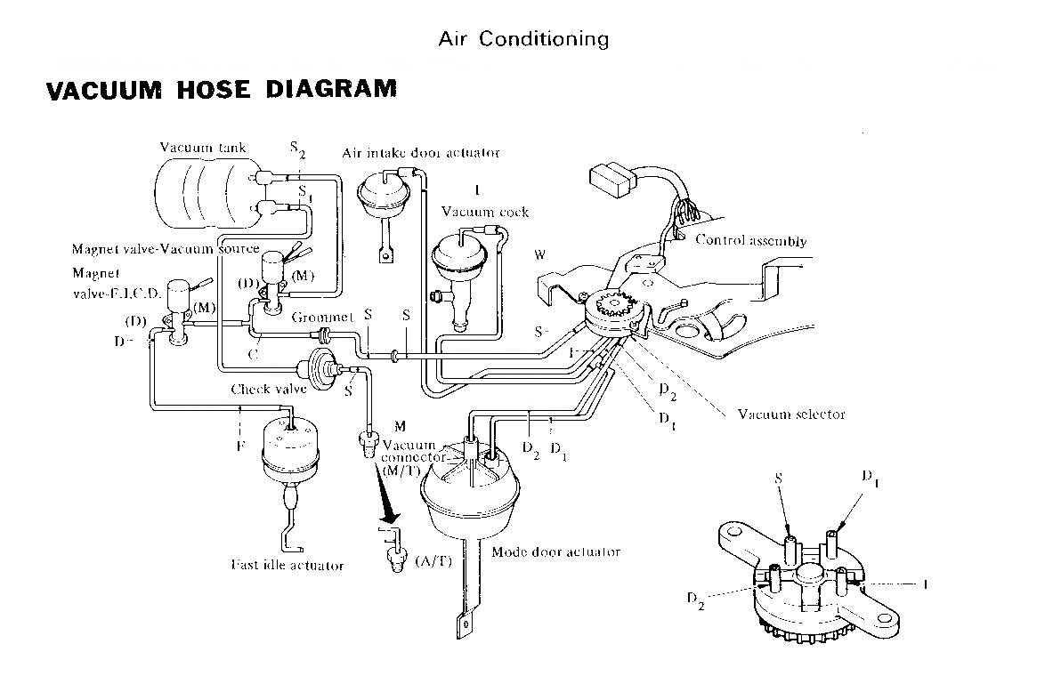

Ok, this hose (looks like a vacuum hose maybe?) was unhooked from that T-Joint.....will this cause the car not to start, if so, where does it hook up?

In #1 that is a fusible link. You need to replace it rather than just solder it or whatever. #2 is the vaccum bottle for your mode door actuator which is for the ac/heater. #3 is a ground wire that should go into on of those wrapped group of wires, at least is does on my car. #4 and #5 I don't have an answer for. But you're right, the PO left you a mess. Maybe this will help. It's the sevice bulletin for the introduction of the 1976 280Z. You need and Acrobat reader and it takes a while to load if you have dial up. There are a couple of charts in the electrical section that may be of some use to you.

You should probably get a FSM (Factory Service Manual) instead. That other manual won't help you out too much. As far as picture #2, #3 are concerned, the following attached file should help you out quite a bit...looks like the PO "REALLY" did a number on that puppy. FSM will have a really good wiring diagram in the back to help you sort things out...
The vacuum line will go into the firewall through the grommet shown in Pic #3, the 'nipple' as you refer to it. Inside, you should find another 'tee' vacuum fitting to connect to.
