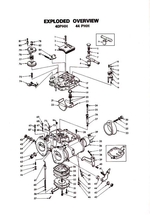

Pilot Screw is #65 in attached diagram.
With me still unpacking from a recent move I can't seem to located my PHH manual anywhere....
Can someone remind me what the base setting on a 44PHH is for the pilot screw is?
2 turns out from seated?
