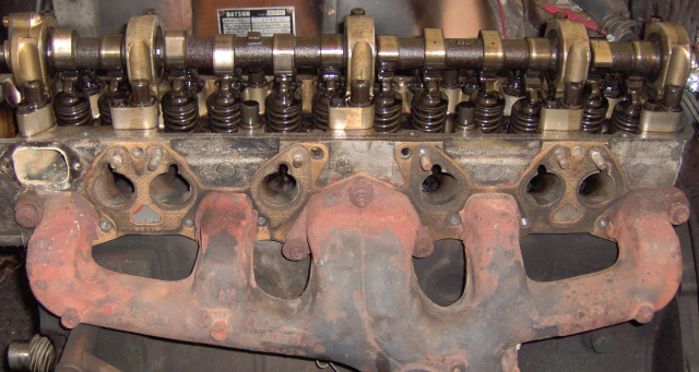

I just took this pic. It is a Fel-Pro gasket. You can see where the carb intakes will go. Good luck.
So the carb intakes have plenty of metal to cover the notch and still seal OK? I ask this because I don't yet have the intakes in my possession.

Is that a square port 240Z exhausy manifold on a P79 head? How's that working out for you? I was advised that it was not a good idea.

I don't think it is a square port in the pic, but it's hard to say for sure. When I did the swap I used a generic round port gasket from a local parts house. It was listed as fitting all non-turbo L28s from '77-83. Worked (and still works) fine.
