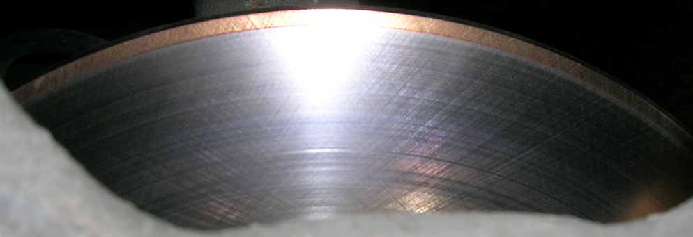

I've just attempted to bed in my new pads and rotors roughly following Carrol Smith's advice of multiple stops, building up stopping severety (thanks for posting Beandip): http://www.classiczcars.com/forums/showthread.php?t=17905&highlight=rotor+myth I am not sure if i was able to heat them up enough as i couldn't find an appropriate road to get as fast as reccomended. I've taken a photo of the rotors after they cooled down. Can anyone tell me if i've bedded them and my pads in correctly?
Thanks.
Jon
