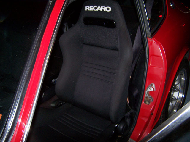

Hi everyone,
This thread is probably more to do with Australian Road laws and such but If you have any good ideas feel free to suggest them.

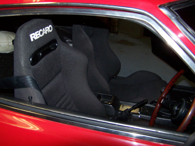

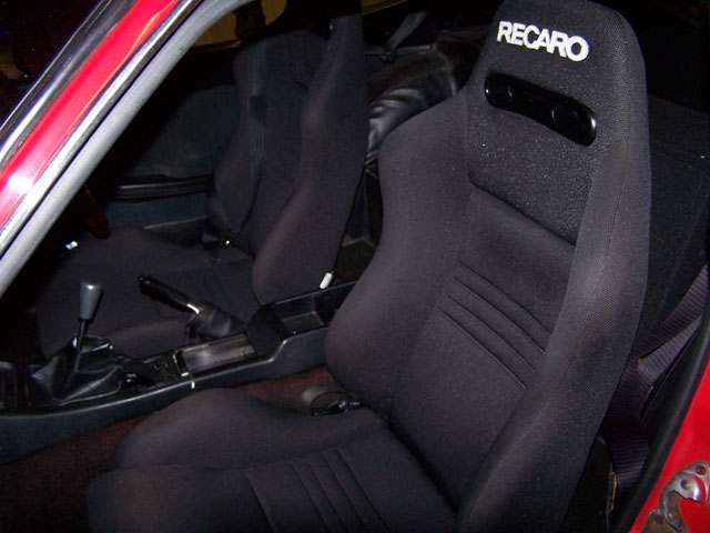

Recently I bought a set of Recaro's(See my gallery). I have pulled the old seats out and done a few measurements(don't have those here). The seats should fit fine but the rails I have will either require redrilling of the seat mounts(attached to the floor) because they are longer and wider.
