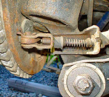

webdawg1 Posted October 10, 2005 Share #4 Posted October 10, 2005 How about you do the following: Pull the "cotter pin" out of each "clevis pin" on Left/Right rear wheel where it hooks into the emergency brake on each rear wheel. After you get the brake handle SNAFU fixed, just release the tension on the emergency brake cable and put the pins and cotter keys back in or use a new cotter key for each one. Keep it simple..... webdawg1 Link to comment https://www.classiczcars.com/topic/17562-parking-brake-now-frozen/#findComment-141106 Share on other sites More sharing options...
