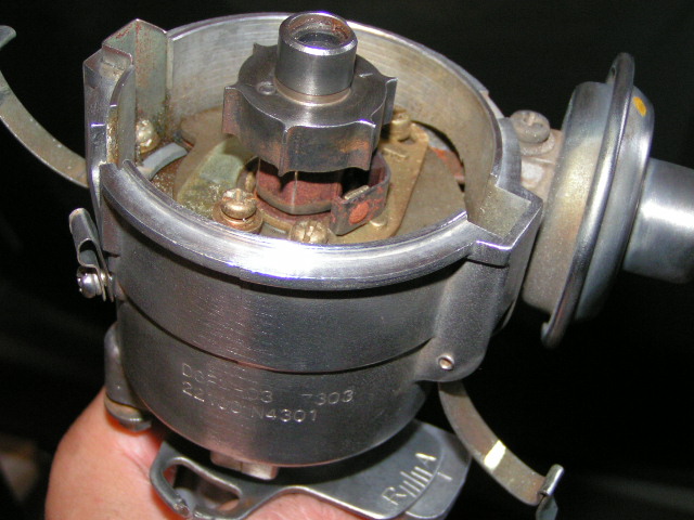

240zwinter Posted October 14, 2005 Author Share #19 Posted October 14, 2005 Found that a old toilet brush grabs the webs but also found out that Black Widows can jump!!!! Anyway finnished the hydraulics and have the Dist. out and cleaned up a bit. Looking at the specs it seems this 280z dist has about half the advance cures of the 240z. Also it looks like it might have been peiced together as I see what appears to be point loabs on the shaft? I dont know if Datsun just carried over the same shaft and added a reluctor or what? See pic. The Mitches book/site only shows the 79 Dist. with the module that is attached and the stator and reluctor are different than mine so its no help. I may go and see if I can find a complete unmolested Dist. with the numbers 30100 634 673 on it since that one almost matches the good 240z Dist. advance curves and should have the newer pick up and hopefully the IC module on it as well. If I can not find a good Dist. anyone have a good site/link to a rebuild of a early 280z Dist.? Link to comment https://www.classiczcars.com/topic/17606-need-ignition-help/?page=2#findComment-141775 Share on other sites More sharing options...
