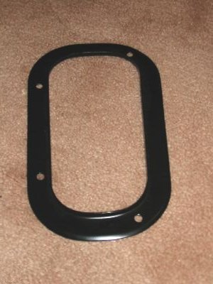

78 280zcar Posted October 23, 2005 Share #1 Posted October 23, 2005 I bought this shifter boot for my 280z. http://www.courtesyparts.com/Merchant2/merchant.mvc?Screen=PROD&Store_Code=CP&Product_Code=32869-S30But when it is in neutral it pull the boot up, is it suppose to be like that or no. I finally got my engine back together havent got to run it yet, I am a little scared to start it because I put 3000.00 into the engine and to have it not start would really upset me. I will post some pics of it tomorrow and pics of the shifter boot to see what I am talking about. Shane Link to comment https://www.classiczcars.com/topic/17699-shifter-boot/ Share on other sites More sharing options...
webdawg1 Posted October 23, 2005 Share #2 Posted October 23, 2005 Did you use the "Hold Down Ring" and four screws to attach the "Shift Boot" to the transmission tunnel ?? Should look like the following attached image... webdawg1 Link to comment https://www.classiczcars.com/topic/17699-shifter-boot/#findComment-142691 Share on other sites More sharing options...
78 280zcar Posted October 23, 2005 Author Share #3 Posted October 23, 2005 No, I actually didnt know that one goes on there! You wouldnt happen to have one would ya. Thanks Link to comment https://www.classiczcars.com/topic/17699-shifter-boot/#findComment-142693 Share on other sites More sharing options...
