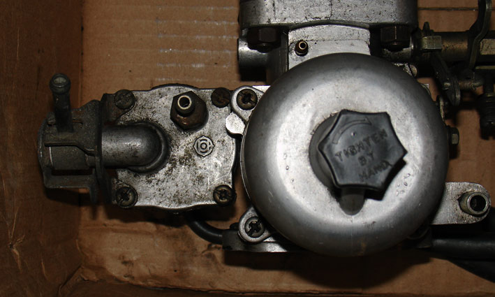

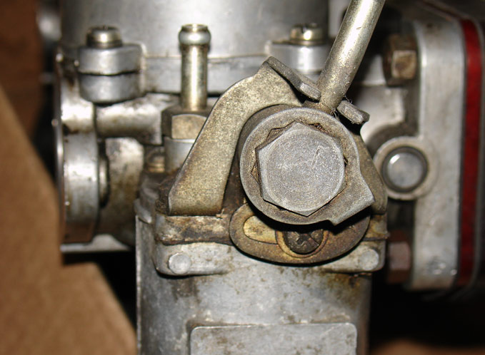

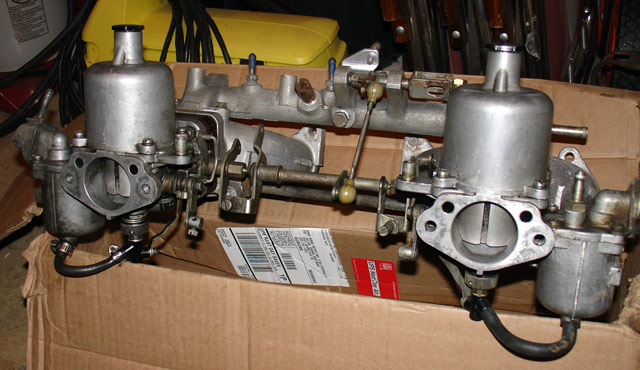

The carbs I acquired to go on 12746 (build date 10/70) have no drains, and I don't know if you'd call my float covers round or square, but they do have 4 ears/screws. The inlet does appear to have a banjo bolt that attaches it, and mine have plastic damper piston caps.
Seems to me that the mere absence of the float drains is not a big deal, I seem to see them on eBay fairly regularly. (Unless the same few sets are being sold over and over again! LOL ) The part of that description above that I've never yet seen is the metal damper piston caps. So maybe that is the part that truly identifies the earliest carbs. I dunno...
As for my set, it doesn't really matter to me if they're the "correct" carbs for my car. My goal is to have a period looking daily driver. The original engine was already long gone when I got it, and I'm going to swap a manual transmission into it as well. My car will never be original again, so I don't care if they're the right ones, as long as they work. (And they will.) That's not to say that I don't understand the desires of those folks doing bone-stock true restorations - I do, because I've been there too. That's just not my goal for this car.
The pictures below are of my (probably) not-so-rare carbs.
