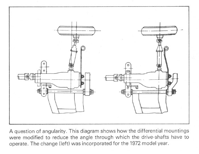

Ok I ran into a problem, the muztache bar I pulled of a 73 240z does not seem to be the same one that is on my early 1971?
The post's in the back of the Diff housing are bigger and I wonder if the Diff is a R180 or R200 etc. ?
The bar that came of my car is wider its 2.360" and the holes are bigger 0.690" compaired to the bar off the 73. The 73's bar is 1.8" wide and has 0.590" holes for the diff posts. They also seem to be bent diferently with about 1.8" difference in the bend. All other dimentions are the same bushings, overall length etc.
Anyone know if its because of a different diff or was it on purpouse to allow for the sway bar to clear? The smaller one off the 73 has solid bishings and the one off my car has 2 slots through them.
I would like to keep the stiffer bushings in the smaller one and maybe drill out the holes and see if it works backwards to compensate for the difference in bend?
Any idea's
The diff actually sat about 1" forward in the earliest Zs (comparatively) and when it was found that this created vibrations and U joint failures they moved the diff back about an inch in mid 71 to compensate. The mustache bar is different, and the transverse link that goes behind the diff cover is different. I think Nissan had a recall on this and some of the early cars were fixed at the dealer. Quite a few still have the diff in the forward position.

If I understand what you are dealing with . On the early 240s '70 -71 they had a different transvers link and m bar . you need the later link that has a curve in it also when you install the R-200 and you must use it's M bar as well. Plus it must be turned around so the spring pearches are facing the opisite diection the old m bar was faceing . this allows for the longer '' punken '' to fit between the diff mount and the M bar and the drive shaft will be the proper length. The R-200 is larger than the 180 and is about 25 lbs heaver. If you see them side by side it is obvious . The bolts for the mounting of the M bar to the back of the R-200 ''punkin'' are larger also. As for the gearing look to the web page in my privious post and it tells what numbers mean what that are stamped on the ring gear.

I also noticed that the Diff seems to be in the later 1" back position since the drive shafts are at 90 Deg. and the mustache bar is reversed. The back link bar? is barley rubbing the diff so I will need to replace it or just grind a U shaped notch in it for clearance.
