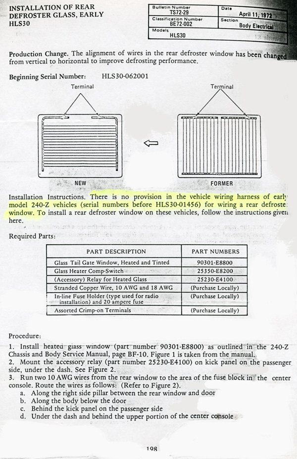

Looking at the IZCC registry, I would say you have an April build date. There is no data-base that I am aware of. The engine is not original, however the carbs could be. I'll bet the hatch has been replaced with a later one. Sounds like it. The early vented hatches came with vertical defroster lines after serial number HLS30-01452.
This means that your car has no provision for interior ventilation. Not a huge issue - the vented hatches notoriously leak exhaust fumes. I wouldn't cut holes in the hatch. Just back-paint the hatch black undrneath the vent grills or leave the body shaved as it is. Shaved bodies are quite popular these days.

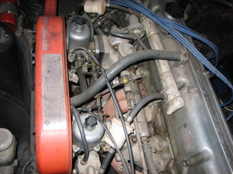

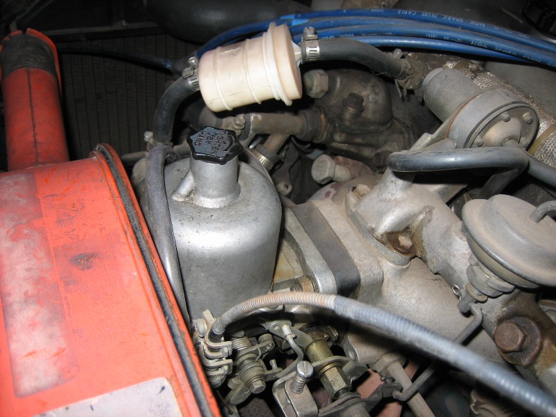

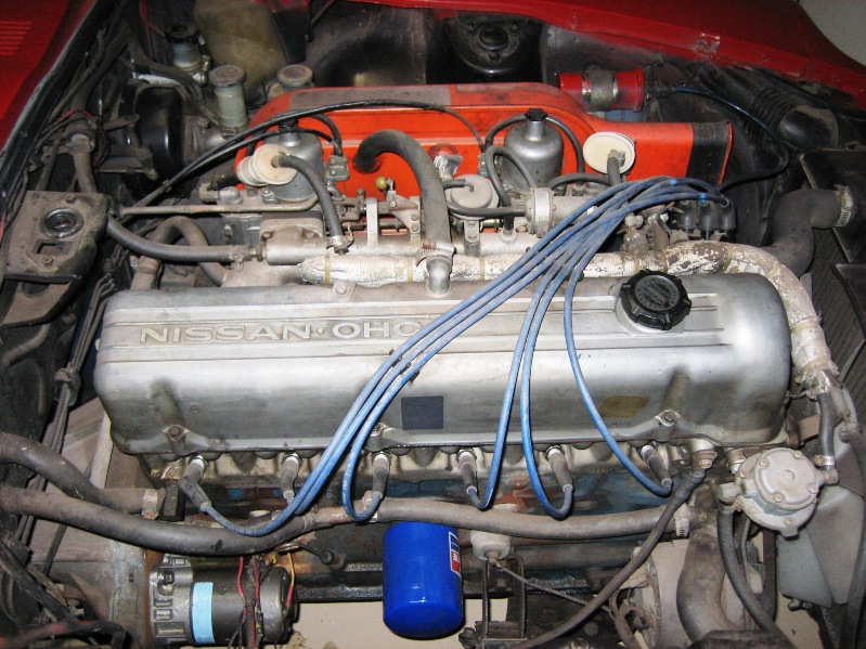

I have attached some pictures of the engine and carbs to see what insight you may have.
Regarding the hatch, there are some 1970 hatch vents on ebay:
http://cgi.ebay.com/ebaymotors/ws/eBayISAPI.dll?ViewItem&item=4586351752&rd=1&sspagename=STRK%3AMEWA%3AIT&rd=1
My thought was to cut holes and attach these vents. I already have the replacement vent covers. That's probably more trouble than it's worth huh? Especially if I'm not going for a totally perfect restoration.....
I think I'll also order a replacement ID plate now that I see that is an option.
I looked at my firewall for a VIN and it is a bit dirty. Can you please help me get more specific regarding the location of the number?
Thanks
