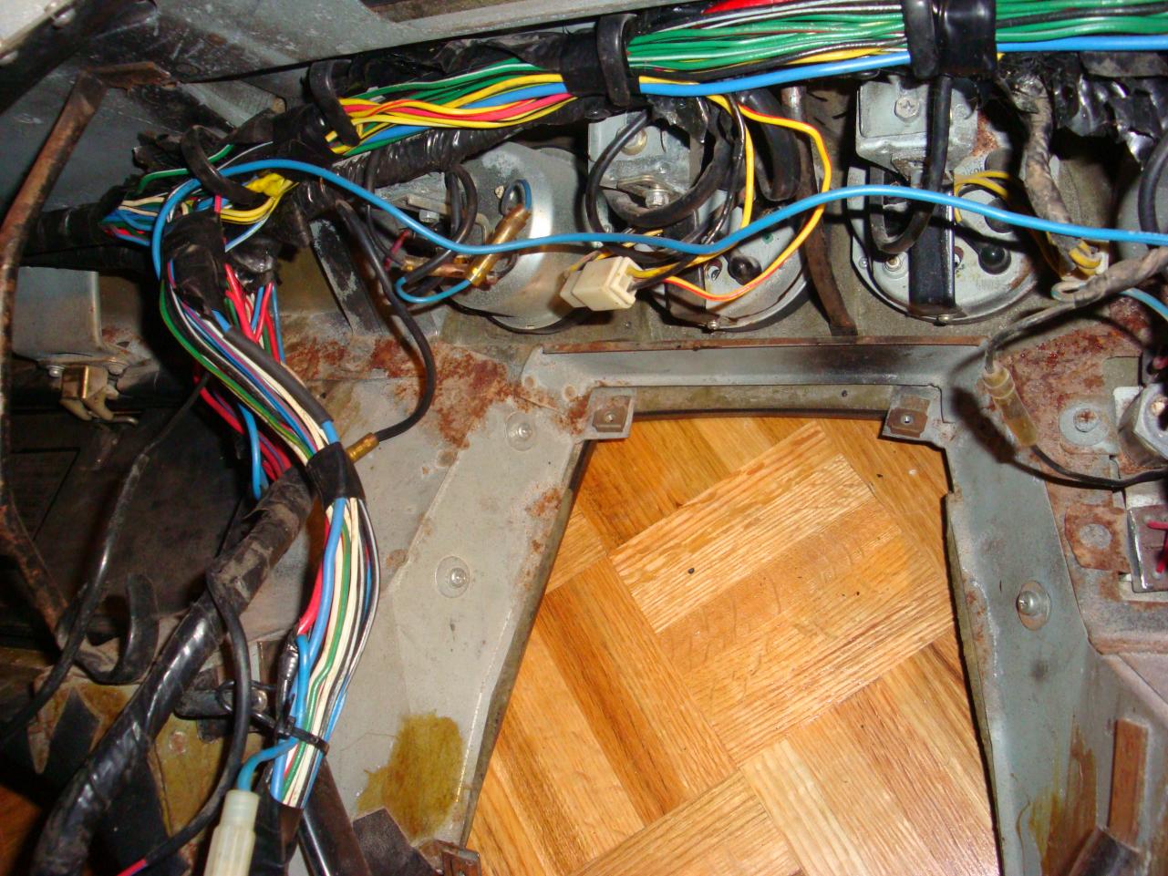

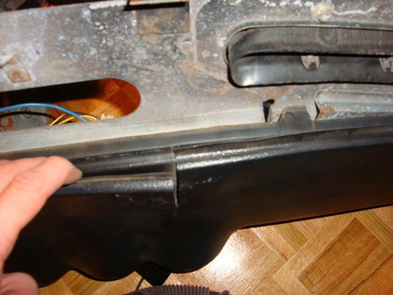

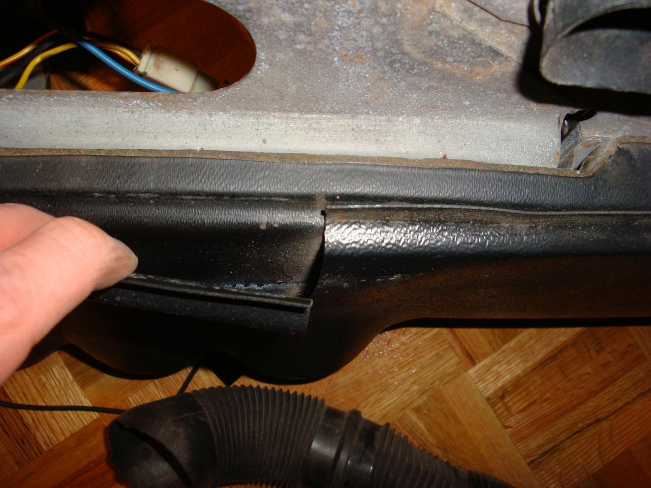

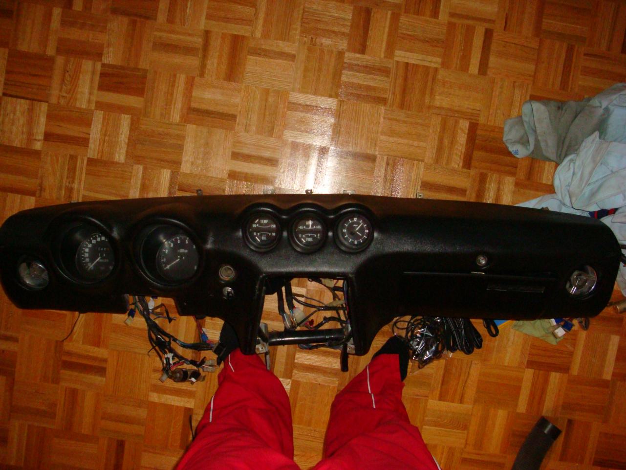

I was wondering, does my dash have a dash cap?
I don't want to try to remove it, only to find that it isin't a cap at all!

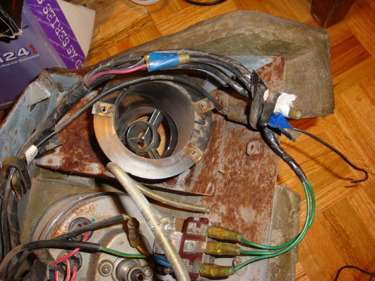

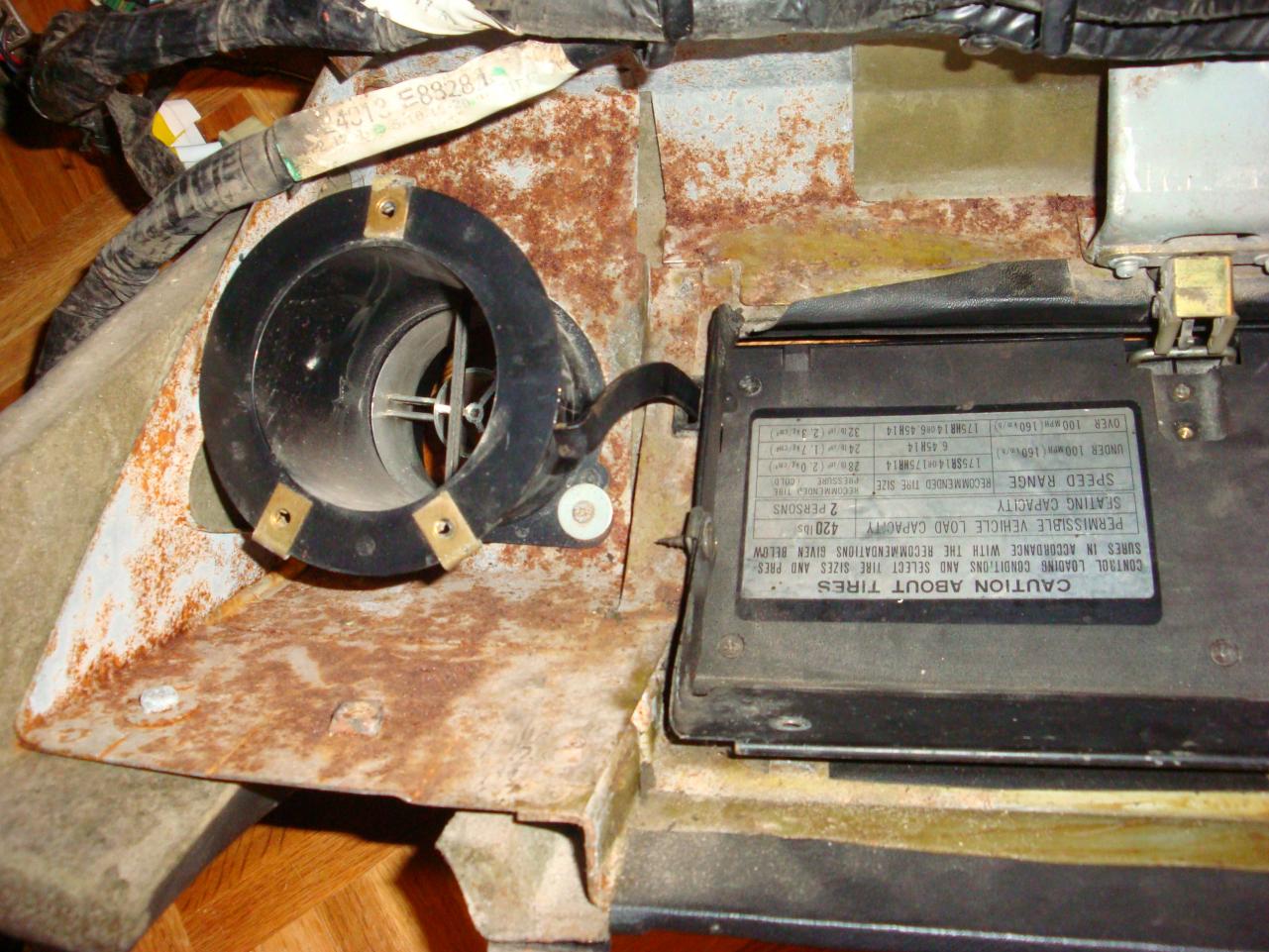

Also (while I'm at the dash), a dremel and POR15 is probably the best way to remove this rust and protect for the future?
Just had to add... my wife is great for letting this happen in the living room :)
Sorry for the hi-jack! If this dash does have a cap on it, then this is testament to how they actually protect your dash...

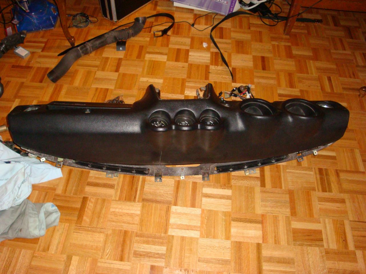

EDIT: here is what the dash looks like overall.
EDIT: It's confirmed -- there is a full cap on this dash.

From the first picture with the cut, it looks like you have a cap on. It should have a plasticy 'tink' if you tap on it, instead of a fuller,dull sound if you knock on it. There should also be a lip you can get your finger under, or a lip that goes into the tach and Speedometer openings that prevents those gauges from coming out, if there is a cap. The original covering should still be fairly well attached.
It certainly looks as if you could use a full de-rusting in a giant tub of Evap-O-rust and a good sealer coat. :classic:
Fiveleaf, that looks like a cap to me. Are the last two pictures, that show the whole dash, after you removed the cap? If so it looks like it is in really good shape. One of the real advantages of the small cap is that it does not interfer with the instruments.

I received an email from the PO (dad) about 30min ago. There is a cap on the dash, and all photos are with the cap on.
The Orginal Dash has seen better days.
I'm trying to glue up the crack in the dash cap at the moment. I'll take pics and let you know how the repair goes on this.
EDIT:
Upon looking further into this (and some other issues), I decided to rebuild the clock (off-time) and tach (dead). Doing so means the removal of the dash cap. There was so much glue in there it started to take chunks out of the orginal dash as I carefully pulled it off. It's like duct tape on cardboard, to a lesser extent. The current cap is also tearing the centre crack much larger. It's terrible.
So... anyone know where to get a new dash cap for less than $100?
EDIT v2.0: MSA has the cheapest full cover dash option, for $100. Many of them out there are $150+
