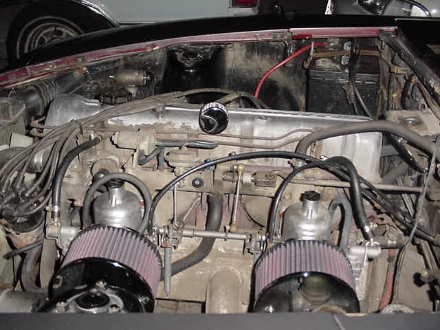

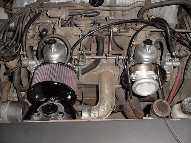

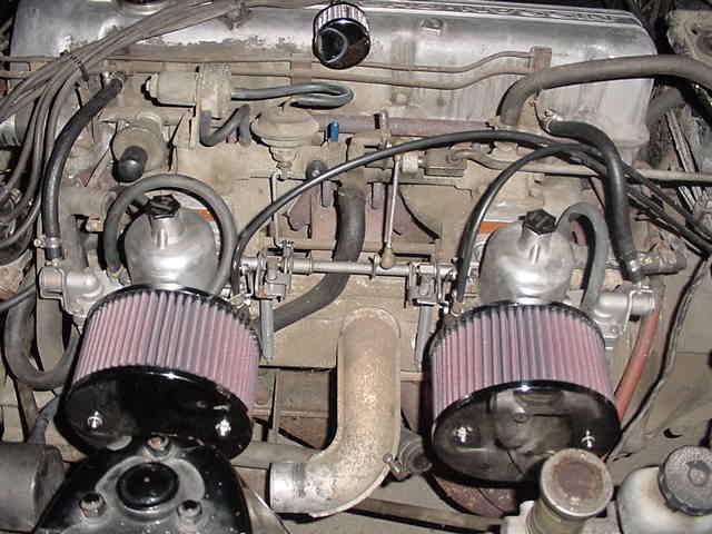

Mark,
I have a picture in my photo album of my engine bay with the K&N filters. The picture isn't at an angle that shows the complete filter set but maybe it will give you an idea of how they look.
I would think you would decrease preformance with that setup. You're allowing two big open filters to suck super hot air in from the engine bay (especially with the header right below it).
At least the stock air box pulls the air from the front of the engine bay (a little cooler anyway)
So Mark, what is wrong with the modified stock air cleaner you are now using? Changing to ITG or K&N's isn't going to make much difference over what you have now?
If it were me, I'd probably want to rework the A/C so that I could use the stock air box. Every other A/C I've seen on Z's mounted the compressor on the opposite side of the engine.
it's definitely not ideal, but it works for me. i haven't felt any noticible power loss, but i can't honestly say i've felt any gains. it SEEMS like it makes more power, but that's only seat-of-the-pants..
since i'm going to be putting my vented hood on, the vent is right above the filters, so i'm hoping that it will bring in more cold air.
